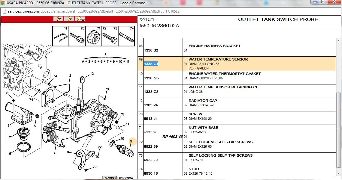

Going by your brief description, it sounds like a faulty temperature sender, one of these things:
Fairly inexpensive to replace:
http://www.mister-auto.co.uk/en/coolant ... 33706.html" onclick="window.open(this.href);return false;
Alternatively, if you have someone with a lexia nearbythen readings of the coolant temperature can be taken whilst driving around, to see if that's jumping around, to confirm it is the sender.
