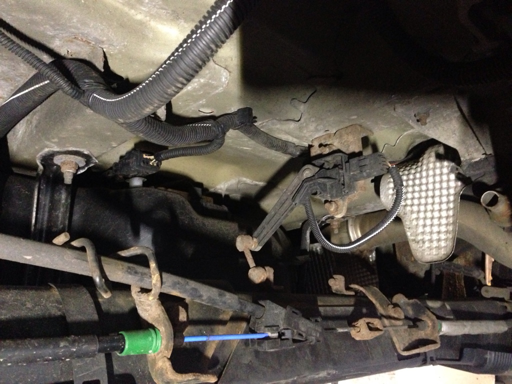

Ok, you may find this useful, we had one in this morning, and this is the rear height sensor. I suspect your problem lies with this, may be just that the link has fell off or got bent. This car is a C4 Picasso, but the same as your van . We have just converted this one to coil springs. The Air bags are currently on back order.
