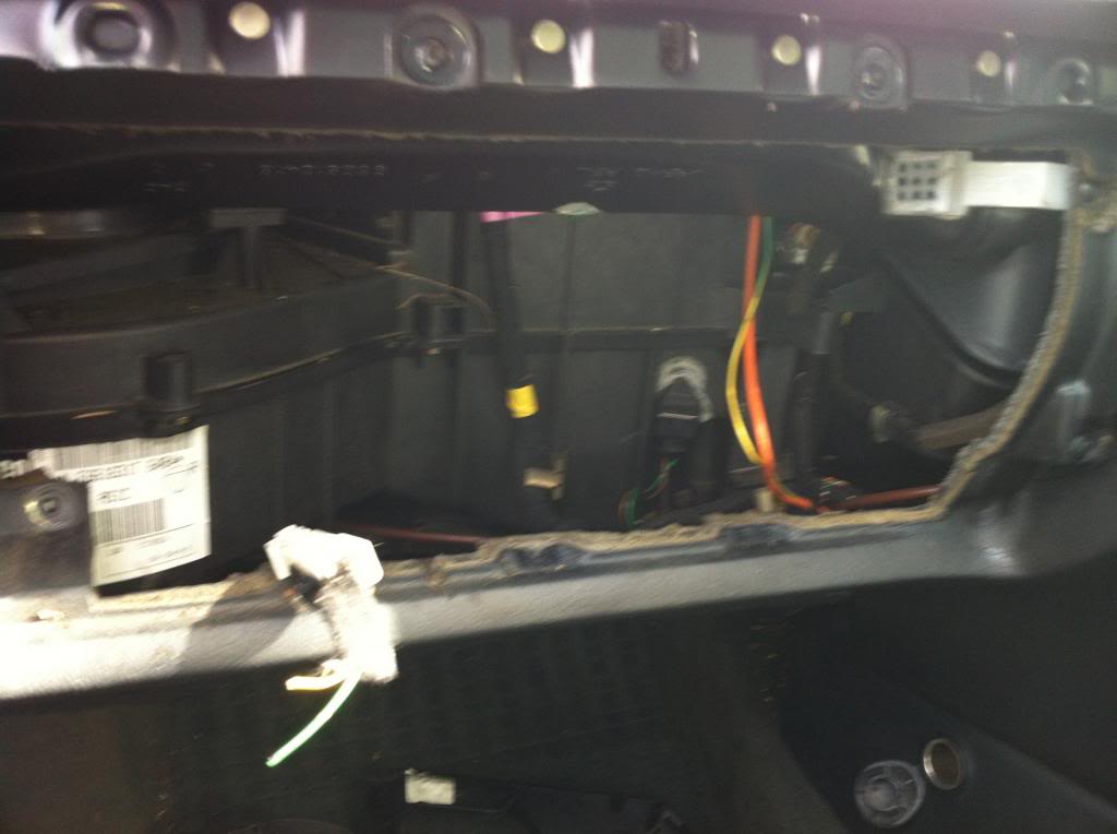

If you removed the glovebox and now your central locking isn't working (as well as the engine not starting) you might have disturbed the CPH (Texton) unit which is mounted behind the glovebox.
This controls central locking, alarm, immobiliser etc. Without this unit working the engine will not start because the CPH unlocks the engine ECU when you turn on the key with the correct transponder in it. Normally you would (on a S2) see the key warning light on the dashboard light for about half a second when you turn the key on, if you don't it also points to the CPH not working.
If you have a Lexia handy try running a diagnostic on the CPH and I bet it won't respond. If you don't have one check the wiring behind the glovebox that goes to the CPH.

Sorry for the "blurry" image as taken on my phone.
Only wires cut were the glovebox light. Everything else seems in place, but where abouts is the CPH?
Dont have a Lexia, so any other options. If all seems connected, would disconnecting the battery for an hour and then reconnecting it be worth a try???
Its worked on Saabs and Alfa's for me in the past
Thanks again
- Dave -
