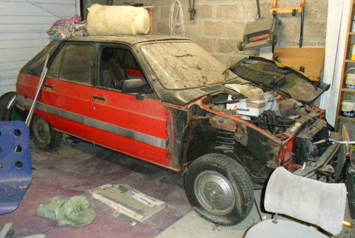

Here it is, now I've cleared a way through to it

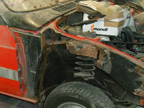

OS inner wing, NS similar!

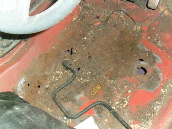

Driver's floor with view of the road

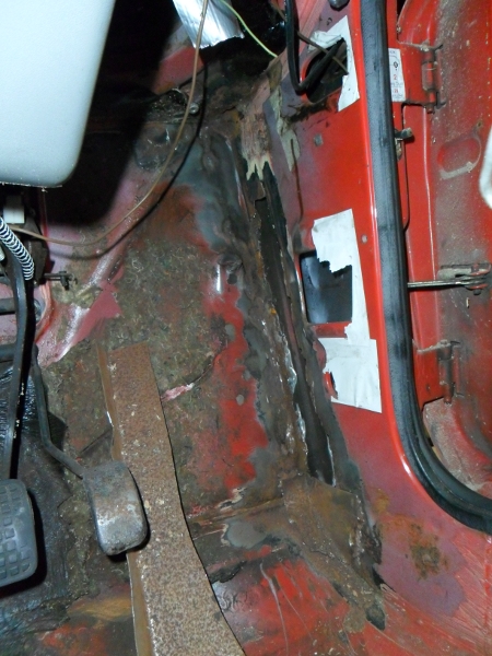

Driver's foot well, partly welded last time

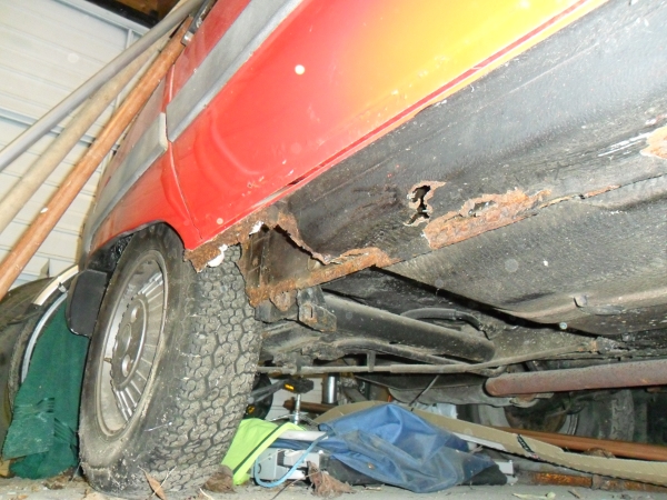

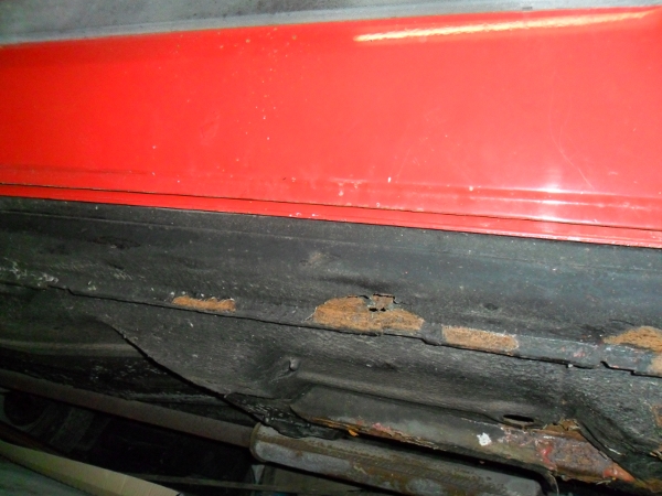

OS Sill under the driver's door - can see through the inner sill here too!
OS Sill at the rear - there was a patch on here, but I think it was stuck on with underseal, as I just pulled it off!
