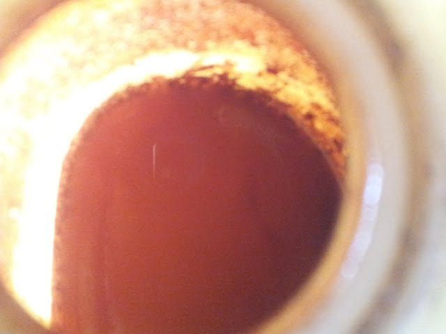

Here's a (rubbish) pic of the expansion tank. Can I remove the tank completely to clean it properly? I don't think it's done the head, there's no mayo on the oil, sniff test proved negative etc. Image

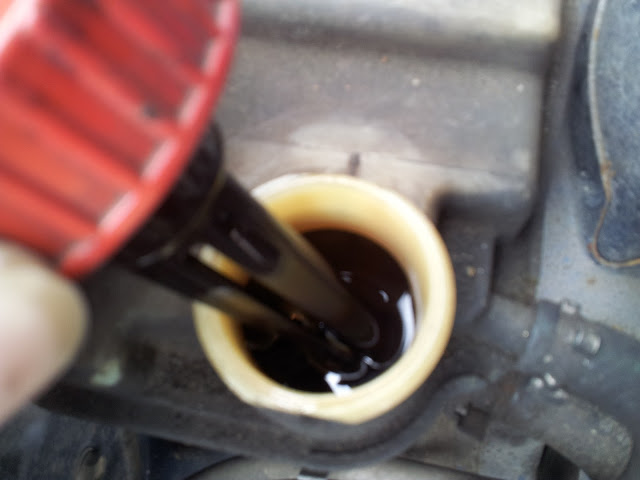

And the power steering fluid - Image

the first thing with the coolant would be give it a good flushing out then keep an eye on it,
and it wouldent nurt to flush the power steering as well,
