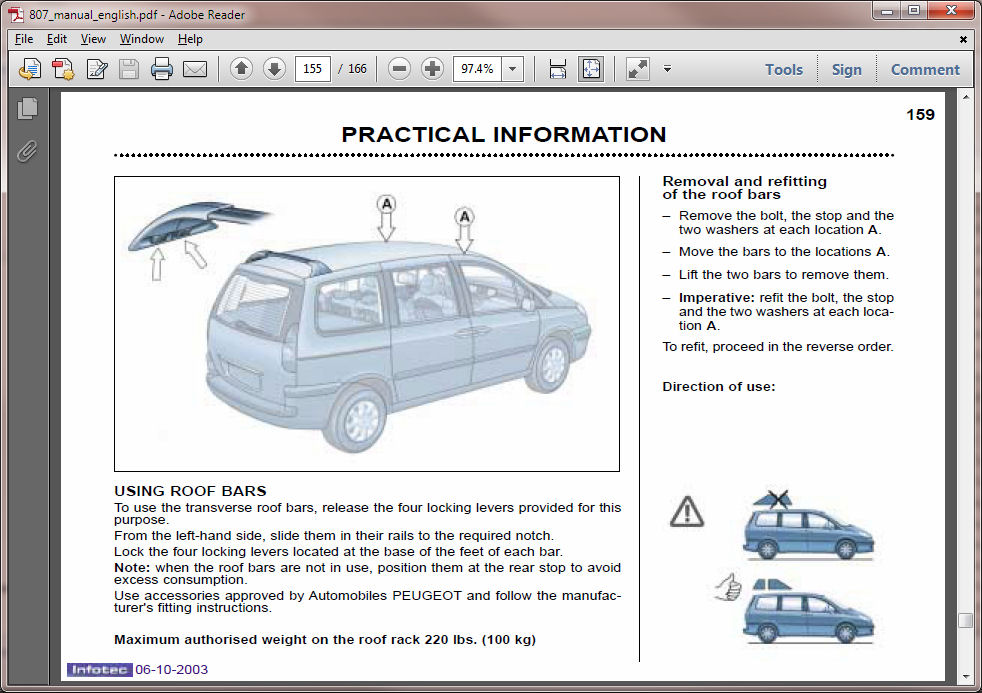

... But how do you fit the roof bars on a c8?
Obtained some factory roof bars cheap but not sure how they are supposed to go on. Can anyone offer an idiots guide?

That's great thanks.
Where did you get the PDF from? I could do with a manual as I currently dont have one.

It's a Peugeot 807 manual. I got it off the eurovan2.com website which sadly disappeared.
I can email it if you PM me your address. (it's 2.3 Mbyte)
