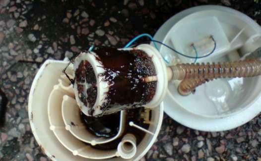

The tank strainer is got at by lifting the rear seat and taking out the big bung under the carpet on the driver's side. then you'll see the fuel pipes and gauge wires going into a circular affair which is fixed to the tank by a big threaded ring. Undo the threaded ring - which can be very tight - and lift the device and up comes the pickup strainer and the fuel gauge sender and float..
This is a picture of how bad they can get:
Picture courtesy of DickieG
Someone a while back showed a picture and dimensions of a wooden spanner to undo the threaded ring but just who escapes me now.
Hopefully it won't come to that Paul but I'd replace your fuel filter ASAP and then if all is OK I'd then do a range check to ensure you have some reserve when the light comes on.
By that way, all that crap in the tank is a normal happening; mainly it's caused by microbiological organisms living in the water that invariably accompanies even the cleanest diesel...

I'd scrape off the worst, soak it in brake cleaner or similar and then blow it with an airline until it was sparkling...
Do it with the fuel level low in the tank otherwise it can be a bit messy!
