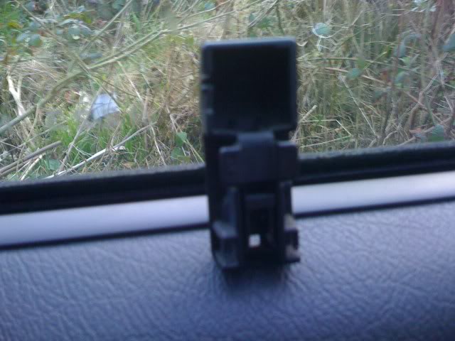

andmcit wrote:Just replaced a mirror on the silver Activa this evening and it took
10 minutes, less if I hadn't kept taking pictures!![]()
Apologies for their being a bit shaky, I was holding the cameraphone in
one hand whilst I was almost fixing everything else single handely!!

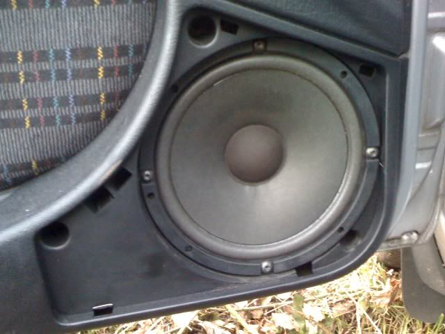

Speaker trim removed revealing x3 torx screws - they're NOT the visible
ones around the circumference of the speaker but set back into the three
deep round cut outs at 11, 5 and 8 o'clock positions:

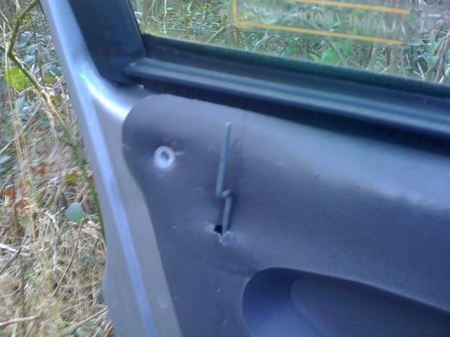

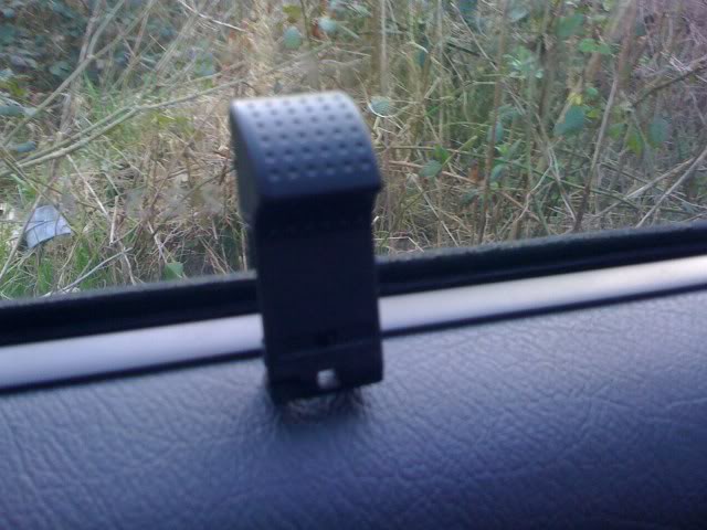

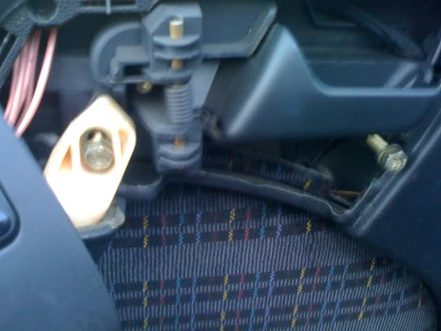

Locking plug removed - you need to CAREFULLY depress the plastic pin
at the bottom just enough to allow it to ungrip the metal rod:

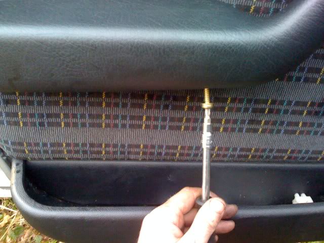

Undo the doortrim x2 screws in the armrest:

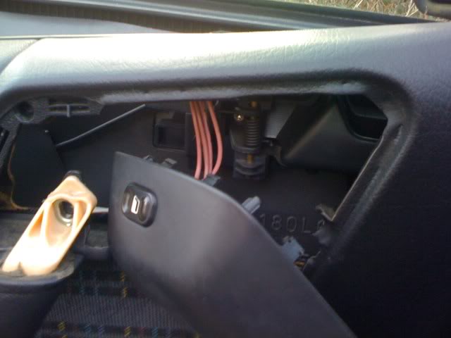

There's a small single torx gripping the electric window panel; once loosened
off the panel simply ungrips by hand working from the lower edge;
You can leave the switch panel attached to the door's loom as it will feed
through the opening in the doortrim.

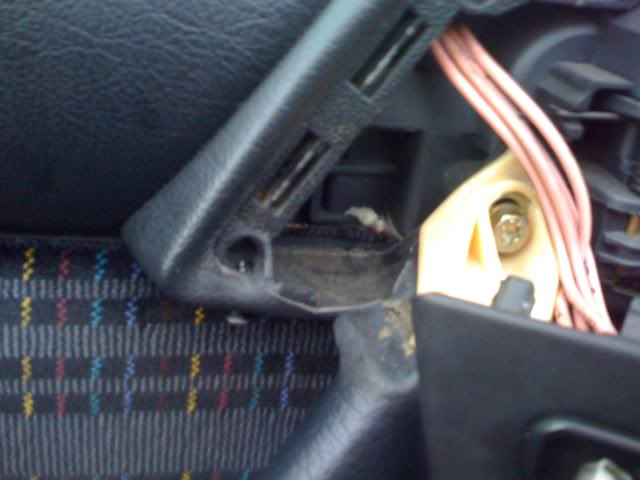

Then remove the two torx screws revealed under the window switch trim
that retain the doortrim:

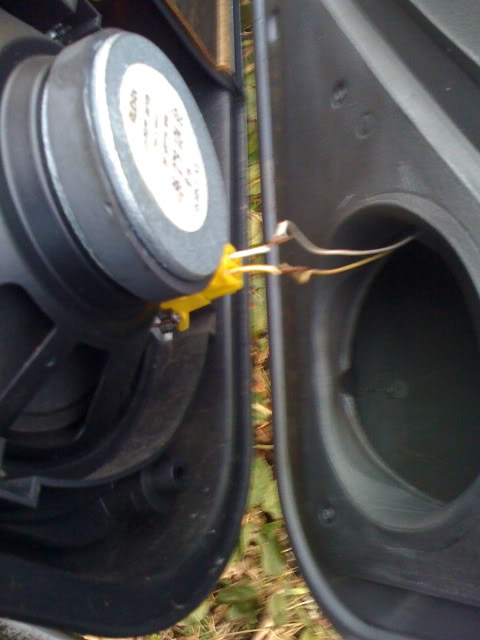

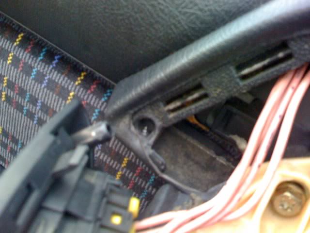

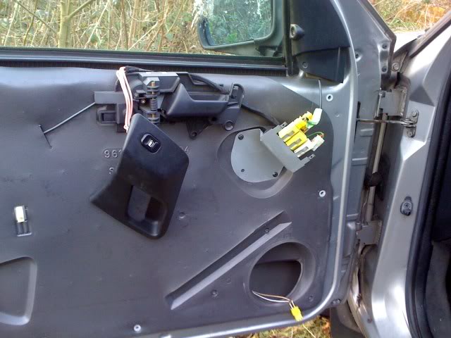

You can them prise the doortrim off popping the plastic grip plugs as evenly
across the bottom width of the door and carefully lift the trim enough to
undo the speaker wire:
You then have access to remove the alerm sensor panel that is a press fit
via x3 plastic plugs into the door:

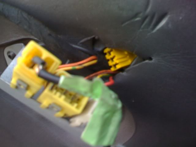

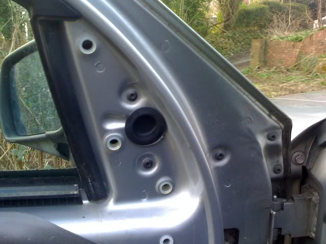

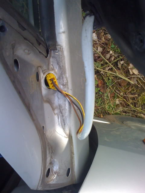

Disconnect the x2 multiplug connectors on the end of the mirror electrics
and feed them out into the door by getting access for your hand
(and arm) through the speaker aperture in the door:

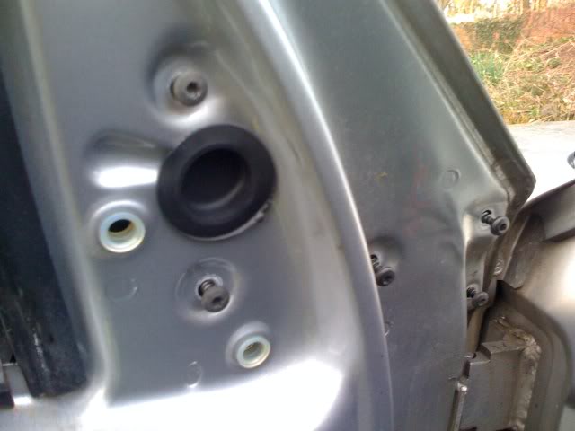

Undo the x5 torx screws fastening the mirror onto the door:
Then feed the wire out as the mirror is lifted off the door:

The only pain is the locking plug pin faff about. I've found you need to
close the door and from the inside depress the pin down into the locked
position and offer the plug up engaging the slot it runs in and then gently
press the little pin in that is lining up with the lower of the two cut out
square windows and press firmly down.
