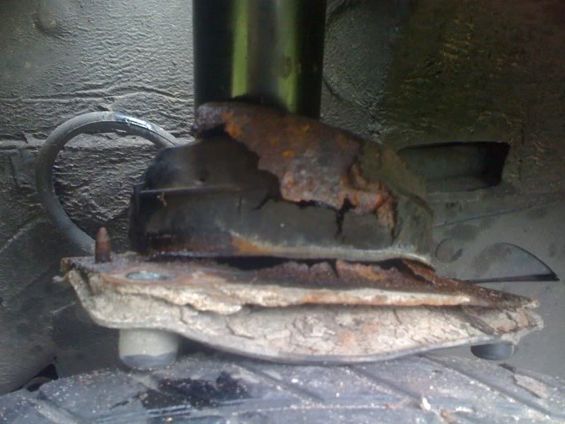

From that speared strut thread referenced above - pictures are always a good way to show repairs:
Important lesson learned the hard way it seems.

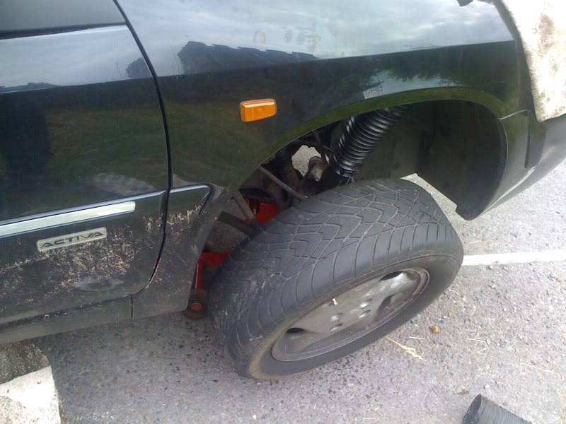

This sight greeted me this lunchtime when I was about to go on a mosey out:
The sphere bracket crown was as rotten as a peach on close concentrated
attention where I tugged all the rubberised covering off the underside, yet
to look at it without actual prodding it all 'looked fine'. The giveaway had I
taken the trouble to be more thorough was the paint lifting on the topside
ledge which flaked away in big swathes to reveal a less than happy more
regularly found bobbly rusty surface.

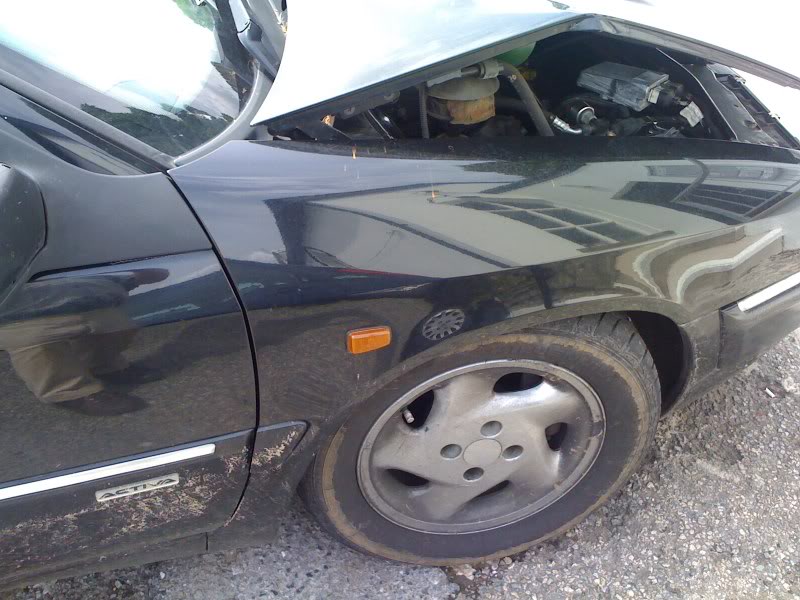

This is the car as I managed to leave it outside my work with the system
fully depressurised - the bonnet is scrap but is still managing to just about
stop the weather getting into the engine bay.

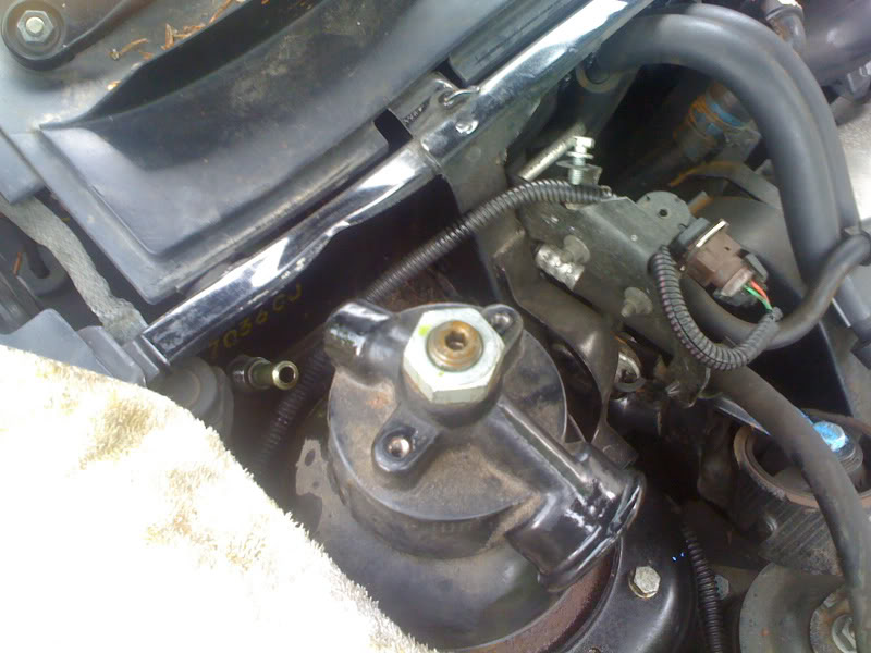

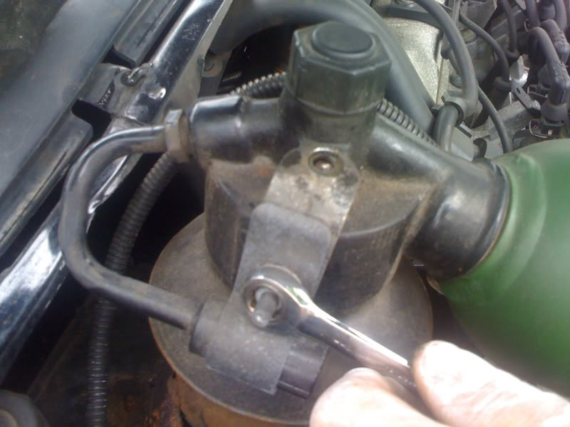

As Richard said earlier, in a nutshell you basically have to remove
everything connected to the 'sphere mounting bracket' or strut top;

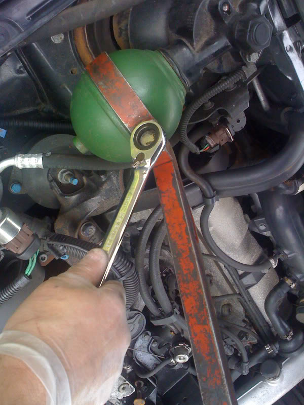

the fluid feed pipe and it's clip/bracket, the main corner sphere and

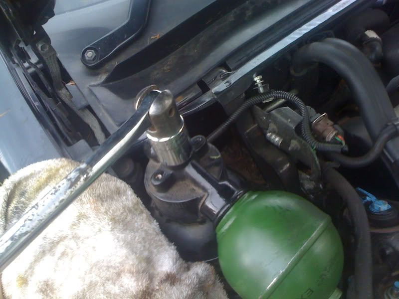

then you need to undo the big nut on the crown that holds the end
of the strut's inner ram against a taper inside the strut top.
sphere wrench from GSF:
As the car is hydractive, the feed pipe for the hydraulics is the same
diameter as your finger as opposed to the usual 3.5mm.
The big nut of the top is usually very tight; here the whole strut head
swung around and round as it'd totally broken/separated off the wheelarch
- I had to put the sphere back on hand tight to brace it against the
surrounding engine bay fitments:

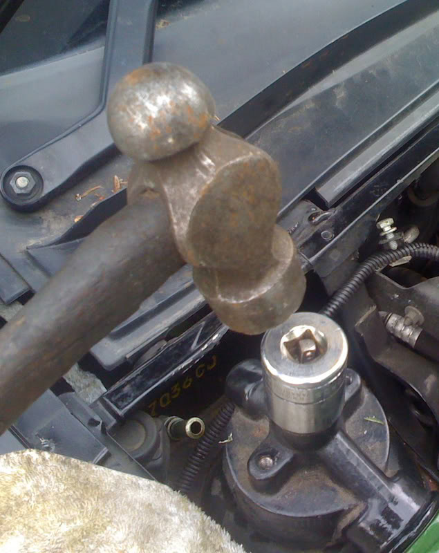

The next bit is my dodge to knock the inner piston downwards into the
main body - I've learned the hard way in the past that the thread on it's
end can be burred over if you're not careful hitting it as there's not much
to see or hold the nut - I usually have another identical nut to take up the
depth of a socket that I can then give a short sharp tap against - here I
used a small adapter from the socket set - the allan key head in the piston
end allows the nut to be threaded off if it catches and just turns:

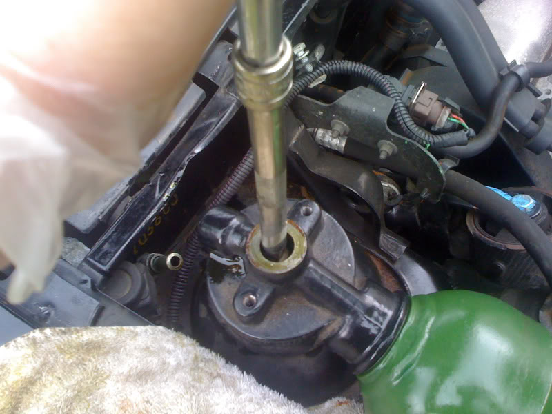

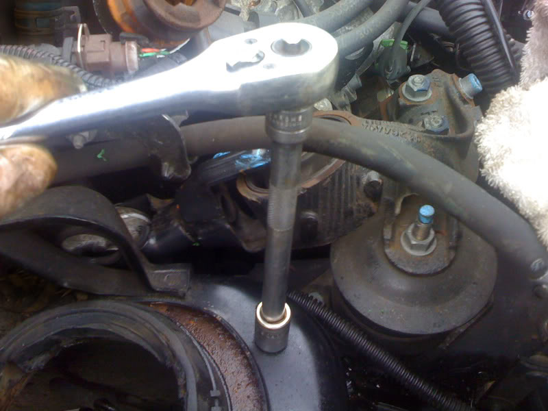

You then need a long bar with a slim diameter to compress the inner piston
downwards into the main strut body which will eject a fair bit of fluid about
the place and you could keep the main hydraulic feed connected until after this stage:

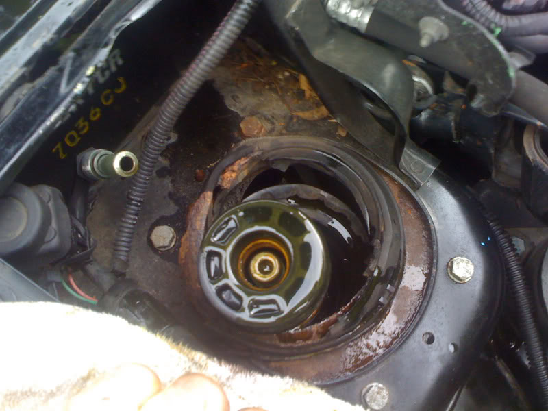

The broken head was loose to simply lift out here though it would normally
be connected to the donut/collar attached to the wheelarch if it's still in one piece
- chance would be a fine thing...

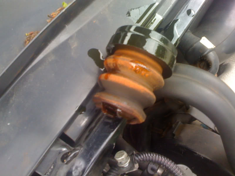

you can see here the top face of the LHM covered bump stop:
and this is that inner bump stop:

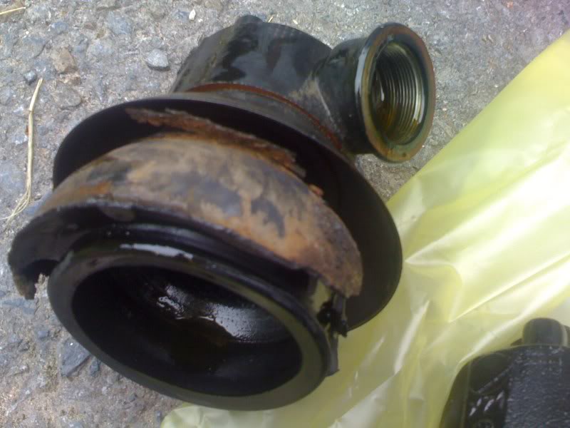

Then the totally mullared collar/donut is undone:
and dropped down the main strut leg:
and fished off. I've been very nasty to it tugging it about before it got
removed and the lower rubber has hidden a multitude of sins behind it's
smooth rustfree outside surface...
A totally rusted lump of rubbish - no wonder it collapsed!![]()

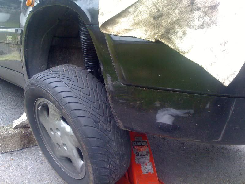

My dodge that is a 'bit hairy', is to have the car supported by a big trolley
jack (additional blocks/timber is additionally used to hold the bodywork up
with both wheels off the floor and the wheel of the corner in question is left
on - I've found it's easier to get a purchase on the whole strut leg and
move it about to get the right orientation
BUT YOU MUST WATCH THAT YOU DON'T PULL THE DRIVESHAFT
OUT OF THE GEARBOX OR SPLIT ITS TRI-AXE KNUCKLE ON THE
INBOARD END!!
For this particular side of the car, I had the car with a slight left lock on it
to help prevent this happening so easily although it doesn't look very nice:![]()

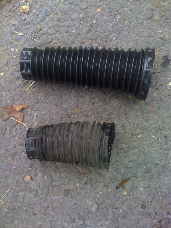

I then fitted the newer gaiter bellows before I forgot (guess how I found
it's IMPORTANT TO DO THIS BEFORE BEING DISTRACTED BY
EXAMINING THE OLD KNACKERED STRUT in the past...)
Old and new:

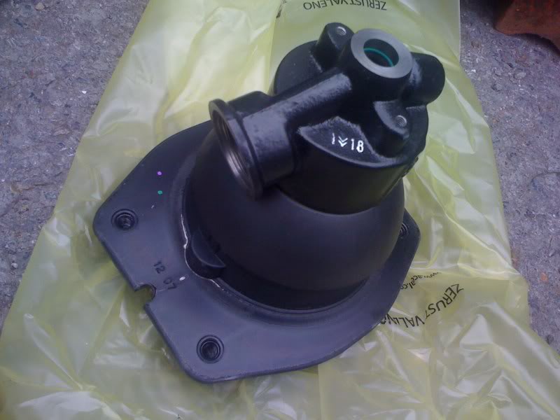

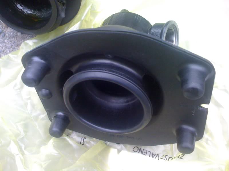

The new strut top has a noticeable bump on it's forward facing edge which
must allow easy identification of it's presence on prospective new Xantia
purchases:

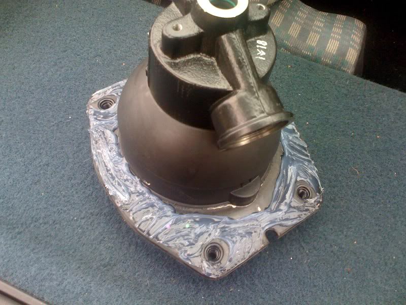

Rightho - the assembly!!
I'm determined that this one will be around as long as I can keep the car,
so lashings of clear silicone sealan**** applied:
****EDIT - not such a good idea I've been advised - Acrylic based? TBC

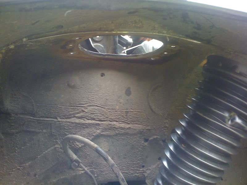

Top of the strut has been swung out to allow access for the old/new sphere
mounting bracket:
Now fit the lovely new strut top and FIT THE BUMP STOP - remember this:
it's a fiddle but you need to fit it inside the strut top head from underneath!!
