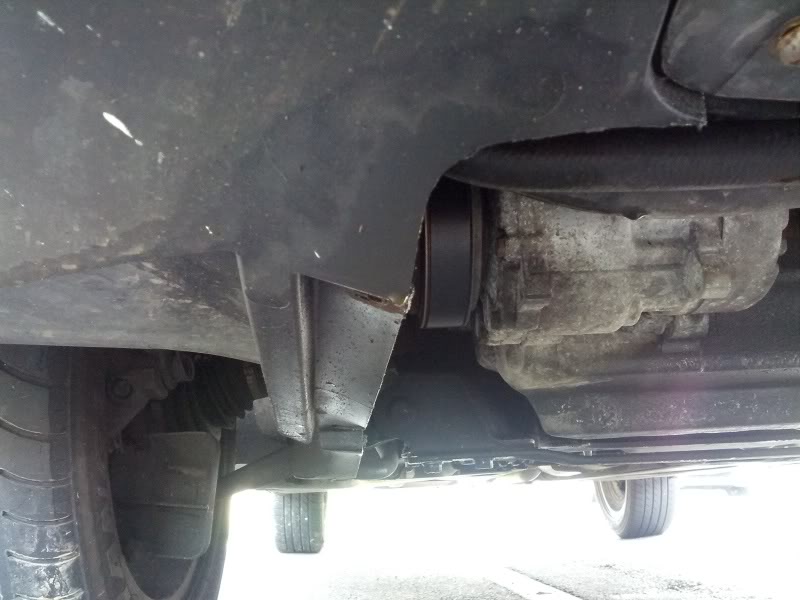

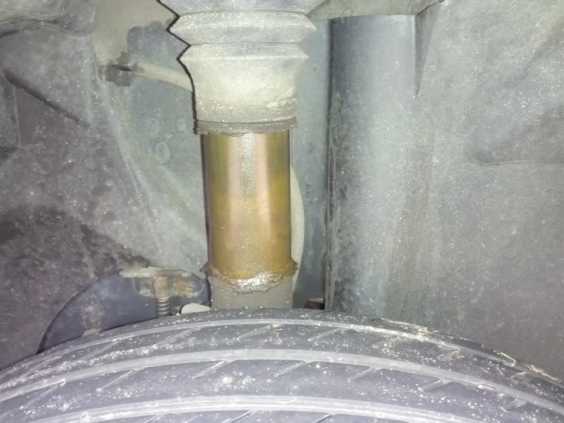

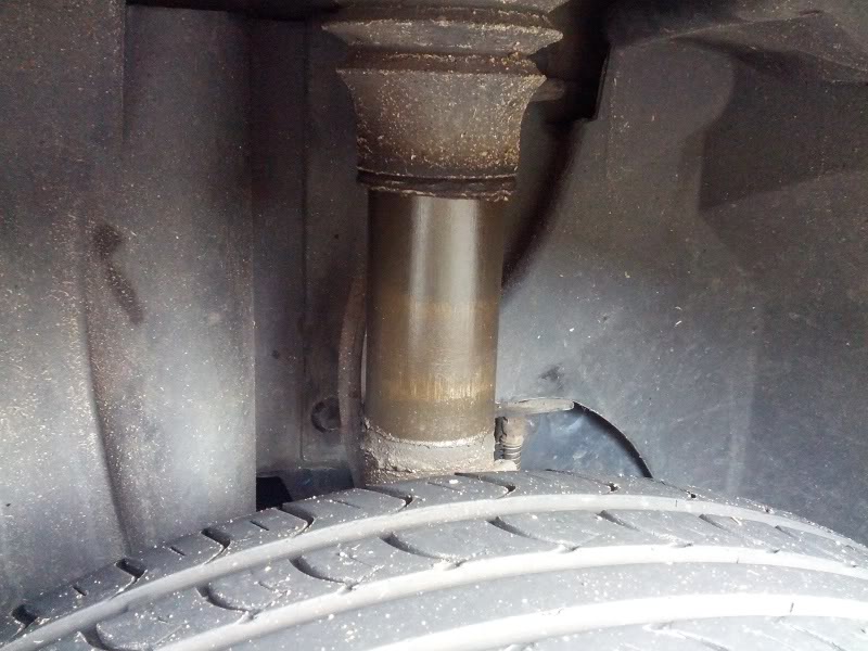

I just seen the reply, I have gonne out and taken some pictures... might be normal as the car has not done more than 20.000 since 2008
At the moment on the speedo it has 86.800 miles.
While I was taking the pictures I realised I have no engine undertray lol ... so will look for a replacement
2 pictures... one of each front shock and the last is where the little drop of hydralic fluid coming off ... from the fact it is very thin and yellow I assume it is LDS?
I had a look on the sphere where that sits on top of the driver side shock and seems dry so that cannot be leaking I guess. I do not know where the middle sphere of the 3+ system is ... waiting for the Haynes Manual to shed some light.
Those pictures were taken with the suspension raised all the way up.
Front Driver Side
Front Passenger side
And the little corner where the fluid drops from (I know not easy to see there is a drop there when the pic was taken it is exactly in the middle of the picture)
Front Driver Side

no its not normal as there should not be any sign of fluid on the out side of any of the hydraulic components,
also these are struts not shock absorbers, basically hydraulic rams

Im no expert as most will say, less so on C5's but in honesty, those struts look perfectly fine to me. They look like a little lubrication on the legs rather then a leak..
Judging from what you say, this sounds more like a return leak. A high pressure leak can drain a system in seconds!!!
