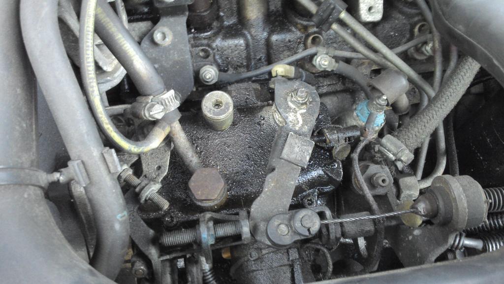

This is happening to mine now, also a 1.9d from 1994 on L reg. Diesel is seeping through the shaft on the top right of the pump.
I've not yet heard back from two of my mechanics so might end up attempting this myself on the road!
How difficult is it in reality and what part(s) do I need?
Is it this?
http://www.ebay.co.uk/itm/Shaft-seal-ri ... 3f36154d37" onclick="window.open(this.href);return false;

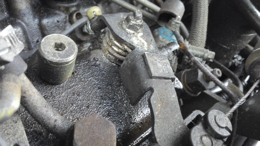

this bit lifts out 1mmish

It's not difficult and can be done in-situ with great care.

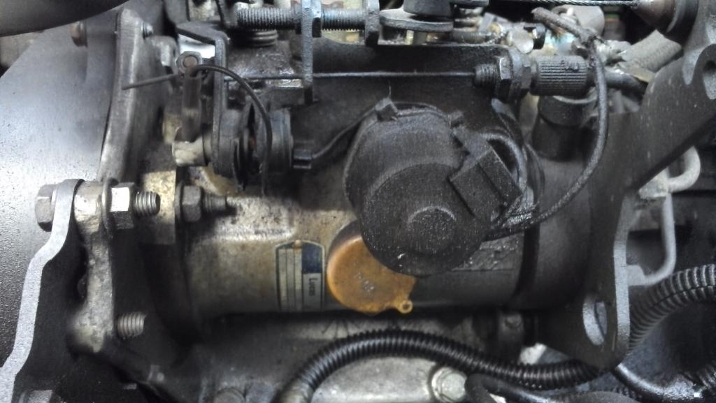

You will need a pukka seal kit for your Lucas pump and that can be bought from any good diesel specialist. You MUST advise the exact pump type and the type number (Starts with DPC) can be found on a blue plate on the underside of the pump body.
The ebay seal is the drive shaft seal and NOT the one you need.
Once you have the seals, clean the pump up until it is absolutely spotless and clean the surrounding the same. Remove the throttle and cold-start levers and all other gubbins from the top lid of the pump. Undo the four lid screws and carefully lift the lid whist pressing down on the throttle spindle. That stays put but the cold start lever will come up with the lid.
Replace the O rings on the throttle shaft, being very careful not to loose the old ones in the bowels of the pump. Replace the seals on the cold start lever noting the orientation oft he cold start cam under the lid.
Replace the big lid gasket and reassemble.
Job done.
Be so very careful no foreign matter gets in the pump at all whilst the lid is off and this is the reason for the clinical cleanliness.
Any foreign items and dirt that do get in will mean the pump having to be removed for a full strip and clean. That is no fun at all but with care that won't be necessary,
