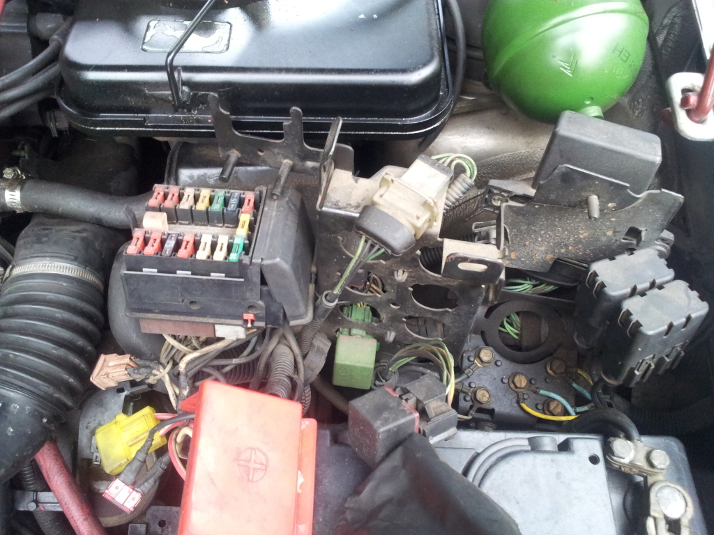

sorry for a late reply, i've been outstation for awhile so had not near the car, however checked the engine bay beside ECU for type of injection but had no idea where or what it will look like.
can give more detailed information please. thanks in advance.

The engine ECU is in the plastic box behind the right hand headlight next to the air conditioning dryer, (on your left looking into the engine bay) depending on your car there may be more than one ECU there, the engine one is the one with the single big long plug on it. Lift it out (can be done without unplugging it) and check for model numbers or markings on the side of it.

It's the other side of the engine bay....
Alternatively post up the last 8 digits of the chassis number, and we can check on service.citroen.

however managed to get to the ecu box but still dont know where to refer so here is my last 8 digit chasis number...
001C2538
please check for me
thanks.

Service.citroen says
Relevant bits in bold - it tells you twice, to make sure!
My Dad's was Magnetti Marelli, and this had odd running symptoms for a few weeks before the crank sensor died completely and there was no spark at all.
