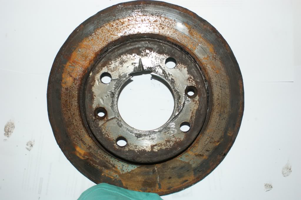

I put a wide chisel in the SDS hammer drill locked it to hammer only and got my Father to rotate the disk as I applied the heavy SDS chisel to the Front of the disc hub we then concentrated on the centre of the disk and
cut out a slot with the SDS hammer action and then put in some more WD40 through the cut out slot and then
hammered the back of the disc once more with the 4lb lump hammer and finally the disc
came away from the hub. =D>
The centre of a brake disc is thinner because it is tapered on the inside of the disc making it easier to
cut with the SDS hammer action. we won our battle finally and I thought if it works why not pass it on I am sure that someone can use this little problem solver, we did consider heating the disc up but worried about damaging the bearings or cv gaiters.
Piccy of the chizeled out Old Brake Disc Below.

Thats fine if you havent just replaced the front shocks and springs pulled a driveshaft in the process and emptied out all of the gear oil and with close examination,of the disc above (pictured) do you think we had a chance doing this?
It looks like its a case of whatever works for you, I don't fancey sawing through a very hard disk with a hacksaw either to be honest with the SDS drill out this took about 3 minutes in all.
