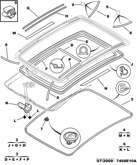

The sunroof switch on my C3 seems to work or not depending on which side you press and how hard (and perhaps on the phase of the moon). I have got the switch dangling on its wire from the roof, but I can't see how to dismantle it - I'm looking to check the spring as mentioned above. Are there any tricks to opening the switch up ?
Thanks, Greg.

I've had a good look, and as expected, they don't detail any modular components internally, as these are deemed to be replacement units as expected.
I can tell you that the part is still available from Citroen, should you not have any luck and is Part No: 6554 Q3. Number 7 in the diagram below, in the UK it is priced at £46.69 ex. VAT (20%) or £56.03 (inc. VAT) as a guide.

So try and reinitialise it first, then you can try Bandit's repair, or finally replace the switch.
