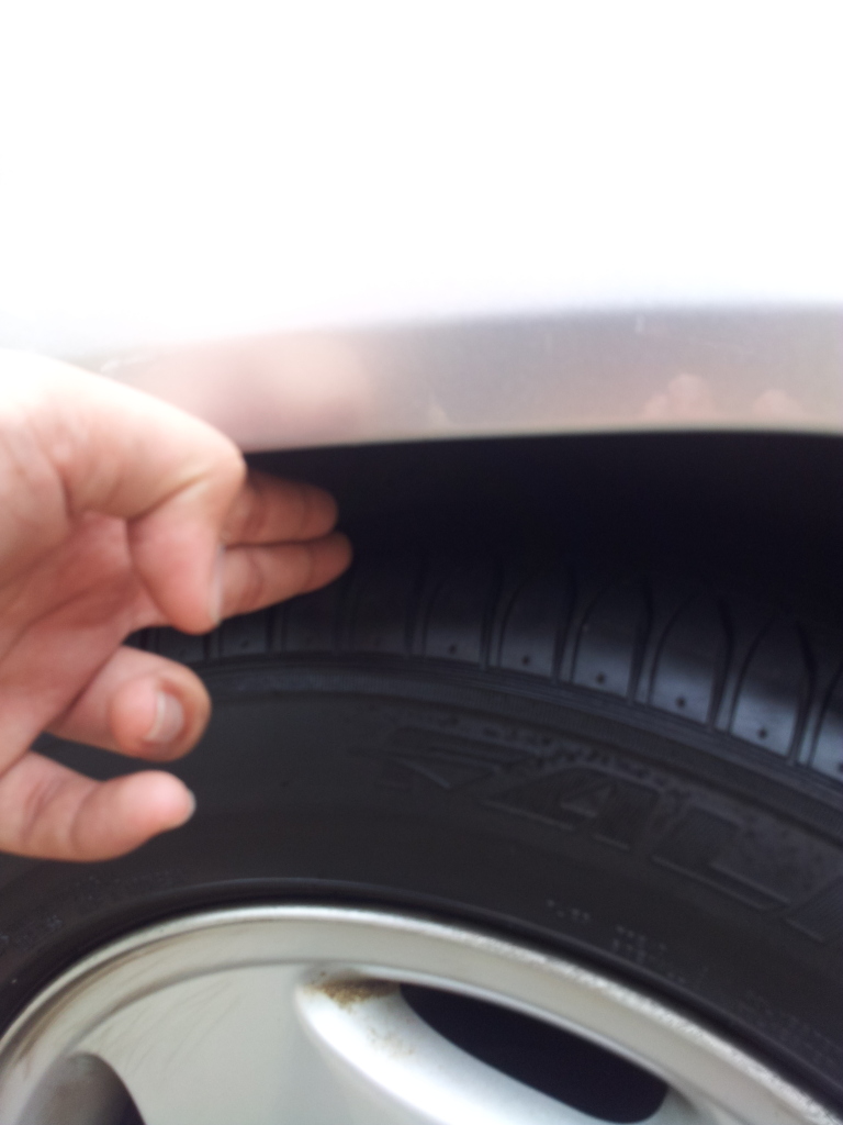

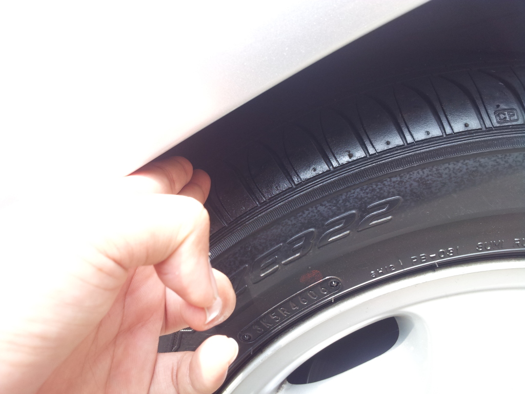

checked the ride height and seems that the back had 2 fingers gap between the tire and wing. does that make a really much difference to the ride? it is really bumpy and it felt stiff when i push it up and down when stationary. the front had 3 fingers gap though. heres some pic of them.

A couple of fingers either way doesn't make too much difference as you say. Now you can be almost certain that your rear spheres need replacing.
