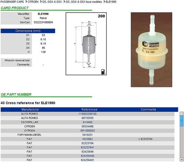

DOMW wrote:Fuel filter - As others have mentioned, theres no fuel filter as such. However, I've had a couple where a normal in-line filter has been fitted just after the fuel tank, attached to the rear subframe by a couple of rubber o-rings. Not sure if it became a retrofit or just a coincidence. Its worth checking there and replacing it if there is. If not, just fit one at the carb end as its much easier to change if you have a problem. Keep a spare! :)
My 1978 X2 has a fuel filter in front of the tank held in by a couple of O-rings. It's the larger of the plastic in-line ones you get. The one I pulled from it was this:
Mecafilter_ELE1990.jpeg by macplaxton, on Flickr
It's more or less the same size as a Hellfrauds HFF200 I got the other day for another car, the HFF201 is the small one.

That large filter is the same as the ones I've seen. I thought it was too much of a coincidence to have 2 Gs with a fuel filter there. My '72 1220 doesn't, but that has had a replacement rear subframe at some at point.
