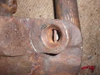

Here are a couple of pictures and a some questions
Pic1-rubber gaiter removed
Pic2-come fine corrosion-radius arm from dismantled Xantia-round thing in place, pin not removed
can the strut be removed without removing the spring pin?
The round bit, still attached to the radius arm rotates-does it prise out? (doe this mean the spring pin has effectively been broken, and doesnt need removing?)
The metal rod which goes into this round bit-can this be prised out, and having been prised out can the strut then be removed?
The diagram might make it obvious-I am not sure at the minute what part the spring pin is deigned to retain.
any help much appreciated as always

The pin should hold the metal rod into the socket which then allows the strut to be extracted once the pin has been removed.

the pin just hold the cup into the arm and does not hold the rod into the cup, as that is held into the cup by a snap ring/circlip inside the neck of the cup,
the rod does not usually come out of the cup unless something is worn or broken

Thanks for your replies. I tried dismantling the cup from the radius arm I took off my old car.
With the tools I have, ie a black and decker with collection of drill bits of dubious quality and age, an angle grinder a hammer, a centre punch etc I soon found out how incredibly difficult it was to remove the pin holding the cup to the radius arm.
In fact I found it impossible. It just would not punch out in spite of drilling generous holes at each side.
In the end I got the mole grips tight round the round bit and hammered up a screwdriver between the grips and the radius arm.
This literally broke the bottom of the cup away from the still in place pin.
The results are as per the pictures
Unless I can get the rod out of the top part of the cup, where it it retained by the snap ring there appears little alternative but to take the arm off, an employ some better tools, sharper better quality drills and drifts, a bit of heat or whatever to get the pin out cleanly. Its unbelievable how the simple withdrawal of a pin due to the demon rust turns what should be a 10 minute job into a saga of torture. Even with the pin exposed as in the picture above, it just will not drift out. What a pain.
Thanks for the exploded picture, it does help.

the pin is high tensile steel so will be hard to drill, your drill will erode the cast iron arm around the pin rather than drill the pin,
i dont find these pins often get stuck to the point were you have to destroy things :lol: :wink:

I have to say those pins either come out easily or a total PITA to remove and as for the ball and cup, I found that there is a magic angle that you can use that will get them in and out fairly easily, either that or heat the cup and cool the rod....

Chris570 wrote: I found that there is a magic angle that you can use that will get them in and out fairly easily,
aaah thats right but its only with the rod removed from the cylinder/strut

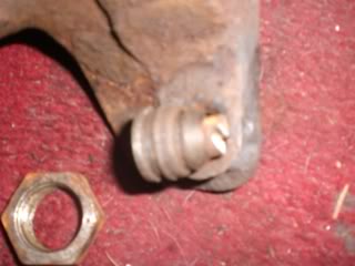

The pin's out, the strut's out!
With the same sort of perverse pleasure Dentists must get pulling teeth I have now completed a sucessful extraction of the pin and the strut :-D
Here is my little trophy
and here is my trusty toolkit. The moment of inspiration was in extending the centrepunch with a 10mm socket, an extension piece, and an impact driver. I could then get a good whack at it with the lump hammer and the impact driver would rotate the punch at the same time-may have done some good although I don't know for sure.
The centre punch was too thick to punch through so I angle grinded it to a smaller diameter. The piece de resistance was the pulling/levering the pin out from the other side once the punch had done the major part of the job with the mole grips ably assisted with the big screwdriver.
I now need a new rubber gaiter for the replacement strut. All the rubber gaiters on the struts I have are ripped and minus the bit that neatly fits round the cup in the radius arm.
