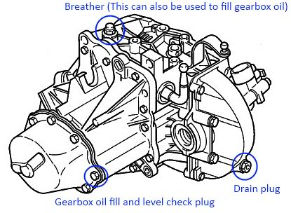

One question. Is there a breather for the gearbox and if so where is it?

mirafioriman wrote:... One question. Is there a breather for the gearbox and if so where is it?
If you also have manual BE3 gearbox, it's capacity is 1.8 l.
After draining I use the breather for filling and simply pour down 2 liters :)
Breather has a plastic cap and the plastic nut can be unscrewed for a faster filling.
