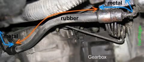

I've never seen one off the car, what does it look like, mostly metal or mostly rubber ? Where does it usually fail ?

It looks like this (# 1 in pic):HDI wrote:I've never seen one off the car, what does it look like, mostly metal or mostly rubber ? Where does it usually fail ?
I think it's either the longest or the second longest hydr. pipe in Xantia.
Usually corrosion destroys the metal - rubber -metal ends and mostly right side as shown in pic.(the end which is closer to the battery) has more corrosion on it.

Thanks for that. If it's a swaged joint thats failed I'd be able to get that repaired. I'll keep fingers X'd for the one off Daves car.

I don't know how those joint s can be fixed because they are pressed and whole pipe is made to be a "one piece"
Edit: Here is a pic where you can see the ends. Can they be fixed?

Yes, if the pipe ends are ok . The ferrules would be cut off after noting the alignment, then a new length of hose fitted and re-crimped. If I'd still got the equipment we used to have in our hose business I could do it easily. Another way to repair it would be to to use compression fittings with a male thread on the steel pipe ends, then make a hose up with female fittings. It would then become a 3 piece assembly.
