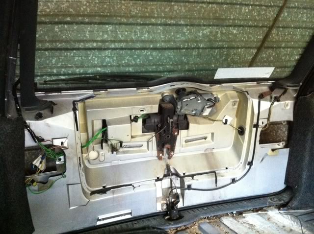

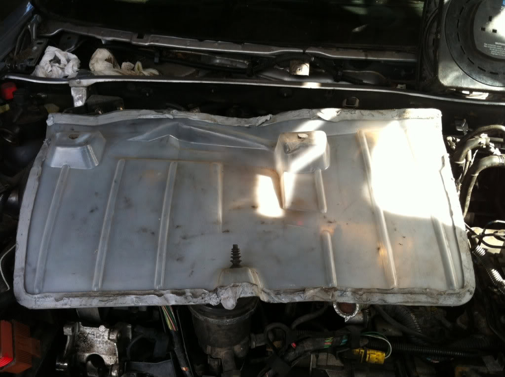

gadgetgricey
Posts: 327
Joined: 29 Jun 2006, 22:21
Re: Where's the doodah that lowers the wotsit for the thing?
Unread post by gadgetgricey »
Hi again Tim,
Its not the tailgate seal, its a seal/membrane behind the "card" of the tailgate itself.
You'll need to remove that first and then you should be able to see the membrane behind it.
Water leaks into the tailgate, usually by the wiper and this membrane then acts as a barrier and stops the water getting into the car, and diverts it to a drain hole over the back bumper (I believe :? )
Basically remove the membrane, clean both sides and then reattach using the mastic tape. Bought all the stuff to do mine, but then the car failed the MOT badly so did not bother.
See below for a couple of pictures of the membrane, and also the tailgate with the card removed. (You can actually still see some of the mastic on the tailgate, to give you an idea where its situated)
Hope this helps.
Good Luck
Cheers
- Dave -
C8 - Petrol Auto (Love the electronic doors)

Napoleon
Posts: 647
Joined: 04 Nov 2008, 18:32
x 4
Unread post by Napoleon »
Oh, I see. So that first photo shows the back of the card, I presume, with nasty rotten mastic?
Thanks Dave, I get it now.

gadgetgricey
Posts: 327
Napoleon wrote:Oh, I see. So that first photo shows the back of the card, I presume, with nasty rotten mastic?
It was more like Blu Tak, which says a lot about the previous owner of the car. :shock:
- Dave -
