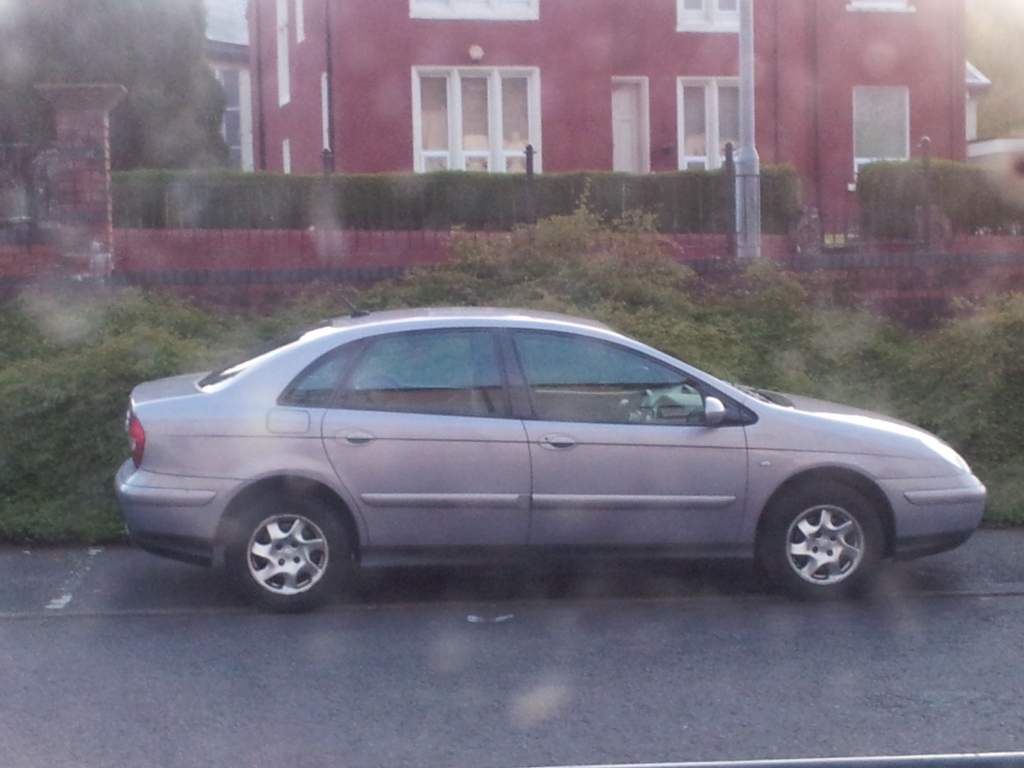

I've been complaining about the rather annoying stationary height difference between the front and rear on my C5 lately.
I plugged in the Lexia and finally got it sitting at equal heights. Weird thing is though, the front is still at its usual 128 steps but I had to set the rear to 144 steps!
Check it out: (excuse my wet/dirty window)

I have to honestly say, the capitals on that brick fence behind, caught my eye more than the C5.
It may be wear to the rear height control potentiometer, or perhaps something like the Xantia link clamp rotation issue that's caused the offset in your measurements.

The issue is a real PITA. I left it parked it up overnight with equal heights then went out to the car this morning (4 hours ago) and it was actually sitting lower at the front than the rear. It's never done that. I then unlocked it and it raised the front to a height higher than the rear. I dropped the mrs off at work, came home and it's still like that just now.
Should I just reset it to 128/120 and adjust it mechanically?

addo wrote:It may be wear to the rear height control potentiometer
This might be correct as right now the rear looks lower than it was this morning/last night
Edit: What has happened is the reference values have reset themselves!
Edit 2: We're now sitting at 121 / 132 in steps which was 135 / 65 in millimetres. Let's see how this holds up.
