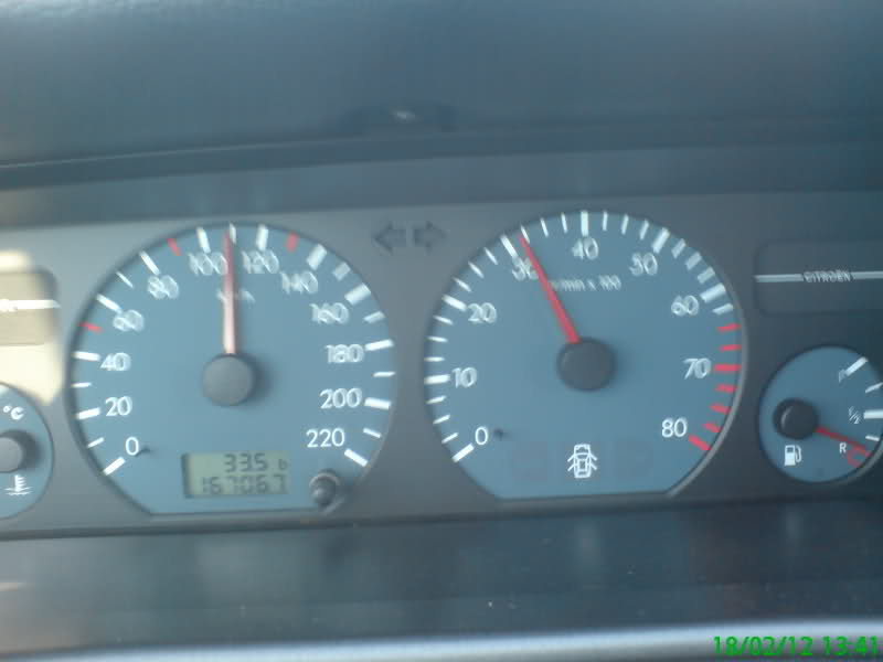

Hello everybody, I'm new on this forum and hope to find an answer to my issue. I have a Xantia mk2 1.8 16V 110hp and the problem is that tachometer (rpm counter) indicates incorrectly engine rpm. In past time I knew that in 5 gear at 110 km/h i had 3000 rpm but now I have ~3250 ...I took a picture to the dashboard. When the engine is the idle speed the rpm counter indicate over 1000 rpm even if the engine is heated (in the past time I had 850). If someone have an ideea what is the problem please help?

Almost certainly the rev counter itself. I've seen it once before where the rev counter was reading wildly high and a replacement instrument pack sorted it.
A lexia diagnosis will confirm for sure.
You may find if you dismantle the instrument pack (fiddly job) and clean the 'fingers' where the rev counter itself contacts the printed circuit behind it all will again be well.
Sometimes if tyhe problem is poor contacts a smart rap with a flick of a finger on the fromt of the instruments will restore normal readings...
