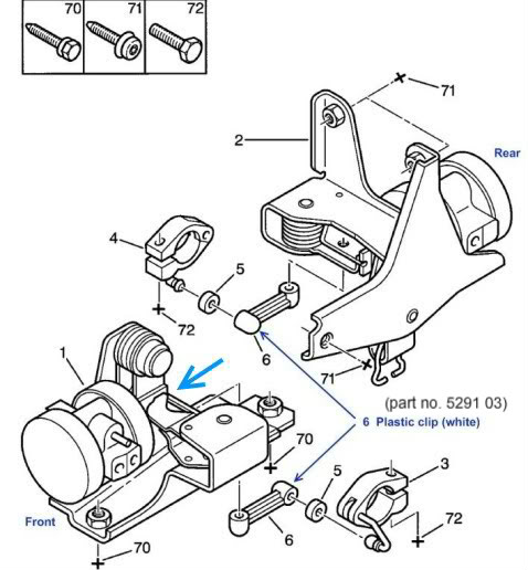

Sounds like rear height corrector plastic clip problem.
This pic might be helpful which I have sent earlier for another case.
(Be careful with suspension when you work under the car! Use jack stands or ramps.)

whereabouts on the car is that diagram for?
and what would be the problem with the clip? broken? need replacing? or come loose or such?
thanks
thanks

In the diagram both front and rear height correctors are seen.
The problem in your case is in the rear one.
Location is under the car, between spare wheel and fuel tank.
Problem is usually popped up plastic clip.
Plastic clip should be normally fixed at both ends.

The reason for the faild CLIP is the Linkages have SIEZED!! Free the two linkage arms up before fitting refering to the diagram, one infront of the BLUE arrow, and the other behind the "71" ...or else it will fail again, or in the end break the connecting arm from the anti roll bar CLAMP!!

According to part list, it is:
5291 03 --- CORRECTION LINK

Number 4 in pic.
5291 17 --- CONTROL LEVER ARM DIAM 23 --- W/O ACTIVE ANTI-ROLL
That's not as easy as the plastic clip fitting but not so difficult to change.
It's connected with one screw #72 in above pic. rear one DIAM 7X100-25.
Edit: I recall reading in one of the threads that Saloon and Estate diameters are different.
This part number was for a MK2 Estate like mine which has diameter 23 mm.

yes.. that link that has broke controls the automatics height... its what refers the height corrector unit to the actual height of the car... so without it the corrector has no idea where to set the height.. when fitting the new clamp it will be a fiddle.. but you will need it on ramps and the engine running.. then have the clamp loosly set on the anti foll bar.. make sure the plastic link clip is attached and BOTH LEVERS ARE FREE.. you then need to rotate the clamp on the roll bar untill the correct height is achived.. height measurements are explained in the haynes book... tighten the clamp do some citrobics to test the height...
its important the two levers are completely free to move with no stickyness or else the rear wontcbehave properly at all...
