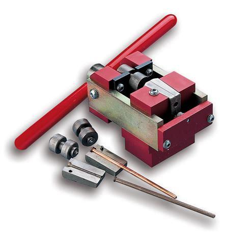

Providing access is OK then it's a straightforward job if you have the correct pipe, fittings and Citroen flare tool. A tool can still be bought new but you'd be looking at well over £100 for a tool that does 3 sizes.
This type of thing but with the correct Citroen dyes.
Pleiades still supply some items but not the flaring tools I'm told.

Best flaring tool on the planet is the Sykes Pikavant, the pro one not the simple versions.
