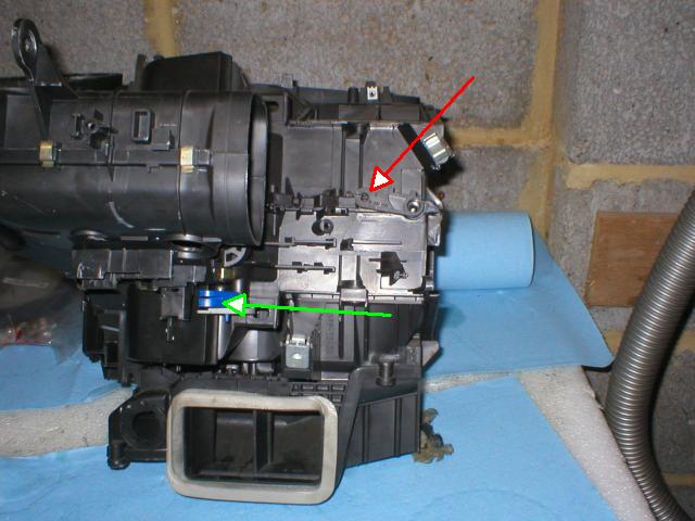

Kev, do you mean the one that operates the top flap as shown by the red arrow in the picture below, or the one shown by the green arrow that operates the blue flap?
Both are absolute sods with the dash in place but just and just doable if you have girly hands. Is the cable there but disconnected or missing completely?
Beware though, it is a 'mare of the highest proportions...
Let me know which and I'll give some more guidance. I've done it and learned the hard way

Thanks for the photo Jim, it has helped immensely
My hands were feeling particularly girly today
I far as I understand it so far after a bit of experimenting, the top lever deals with the windscreen at the horizontal position and footwell at the vertical. The lower one opens up the passage to the upper lever/flap, always leaving the face level ones open. Is that roughly along the right lines?

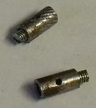

Its the top cable that was missing completely, the outer cable clips and all, leaving the top lever at the horizontal position. I've had a bit of a project day today to rebuild a new one out of some bike gear cable and a bit of 5mm metal bar which I made up into some adjustable nipples. Quite a successful day, had to make some changes to the nipples so they look slightly different from the ones in the photo. Quite pleased with myself! Love the sound of the lathe!

The upper cable being missing on the flap is critical as it really upsets the demist performance...
