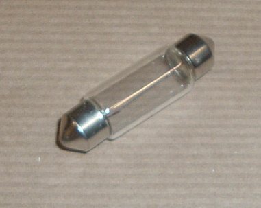

OK, sorry, taking too much for granted there.
Take the two battery leads and a light bulb - a festoon bulb is probably easiest but a brake light bulb (single filament)would be fine, just as long as the terminals are not too close.
Press the battery connectors to the bulb terminals.
This allows the system components - mainly capacitors - to discharge in a controlled fashion - you don't want a sudden rush of current from them and also to avoid sparks. The circuits will discharge quite quickly. A minute is being on the safe side.
Then push the battery lead terminals together (dead short) to dissipate any residual charge.
