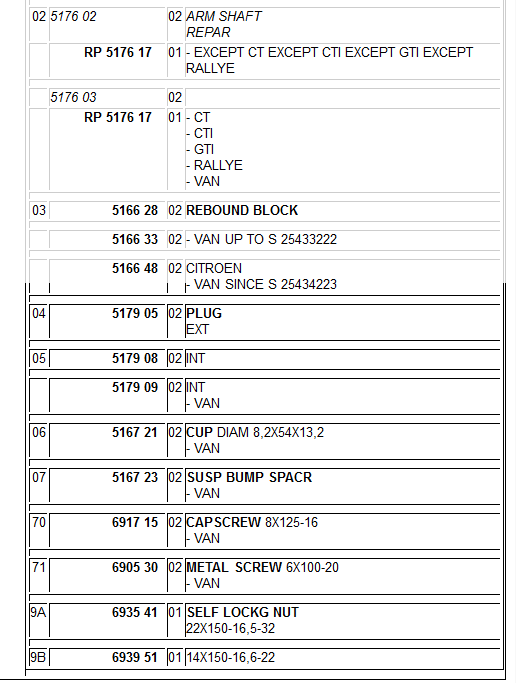

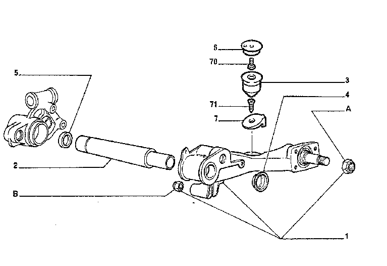

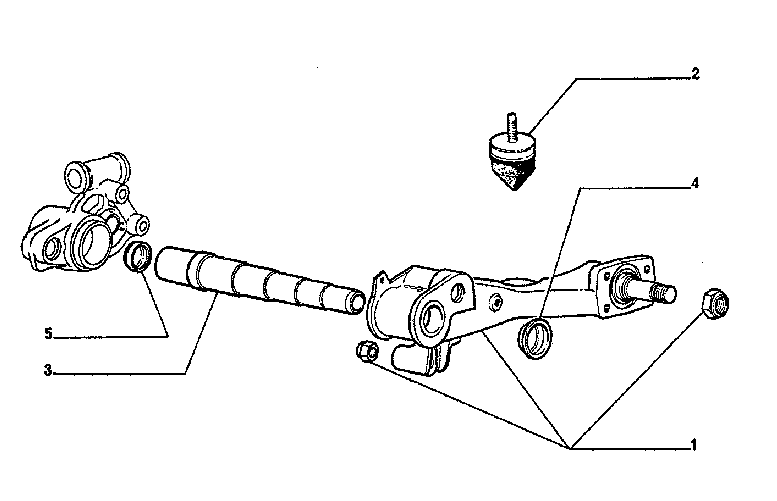

Pics as promised. These are all 205N (newer shape, 1991 onwards) am including disc and drum models. You'll note the screw / mounting looks different, not sure in reality if it really is, has been a long time since I had to change one.
205N Rear Drum
Key for 205N Rear Drum
205N Rear Disc
Key for 205N Rear Disc
205N Rear Drum
205N Rear Disc
