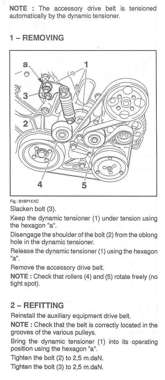

I attemped to change aux belt to day but could not for the life of me find sq hole to release tension! I did it once on a c5 with ,looks like same engine and set up, but I just couldnt find the hole! Where is it?
THanks again, Dave.
Posts: 54992
x 8325
Re: Xantia v6 sudden suspension change.
There isn't one Dave!!!
rather than me waffling away on how to do it, here's the official words... :-D
Hope that's OK.
Quick edit. The small bolts are 13mm and the big hexagon is 21mm. A good long ring spanner is needed to get good torque on it.
Bolt 2 is best got at using a cranked ring as there's not enough space for a ratchet head there...
