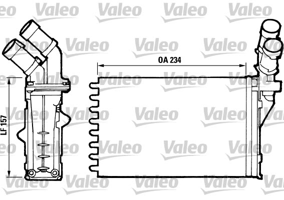

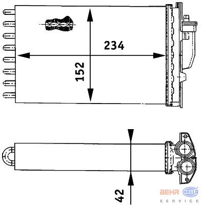

Looking at some pictures, it appears there are differences between the VALEO and BEHR models, just need to figure out which one is fitted to mine!
Valeo measures 157 mm wide x 234 mm high, BEHR measures 152 mm wide x 234 mm high, but they have different pipe configurations.

service.citroen wrote:REFRIGERATION REGULAR AIR CONDITIONNING
However...
service.citroen also wrote:
HEATER
6448 80
VALEO (THERMIQ) -
6448 C9 FRAPE BEHR -
I take it back about the local agent :oops:
but if you take the VIN out, then it says the following:
6448 80 VALEO (THERMIQ) -
- RIGHT HAND DRIVE AND REGULAR AIR CONDITIONNING
- RIGHT HAND DRIVE
So I would say you were odds on for a Valeo....
