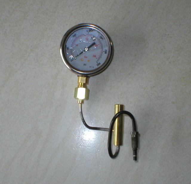

Addo
Could you please describe what is needed to carry out the test you've mentioned? how to make the pressure gauge, where to connect it and what are the correct values?
Thnx.

Unread post by addo »
Dean's got some good pictures/videos of his one in action. It's either on here or club-xm. I've bought a gauge and have spare bits of tubing, haven't yet brazed it all up.
Posts: 55116
x 8406
One of thse will do the job...
And in use on an Activa..

atr
Posts: 314
Joined: 09 Oct 2010, 05:02
x 6
Unread post by atr »
Thanx for the pics. if I was able to see right, the manometer is up to 200Bar. could you please tell us where to connect it (mine is not HA) and what should be the right reading/s?
