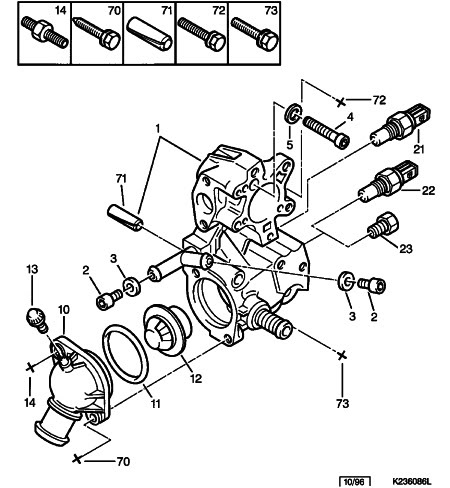

Right, went and got myself 5 litres of nice fresh stuff to refill it. Opened the drain plug on the bottom of the rad. Now my only issue is where
the drain plug on the cylinder head is? Dont suppose anyone can point me in the right direction, preferably with a nice pic :)

Clogzz
Posts: 2125
Joined: 15 May 2005, 18:04
x 40
Unread post by Clogzz »
No drains high up, vent caps only.
Something like items 2 and 13.
Beware of 2, it seizes and the tube then turns with it.
If so, turn it back and loosen cap 13 to let the air out.

Cheers. went for the thermostat out option in the end. just oing to refill now so trying to find any bleed screws i didnt bother finding when emptying :-) .
I see a dust cap up at the pipes where they head in to the heater matrix at the back of the engine bay. It's buried up in there but i assume its a bleed screw for the coolant?
Clogzz
Posts: 2125
x 40
Yes it is, and there may be another one at the end of the heater pipe along the LHM tank.
On some thermostat housings, item 2 is screwed straight into the housing with an allen key head instead of on a short tube.
No problems if it’s seized, I’ve never had any air come out of there, but that was on the 8 valve head.
