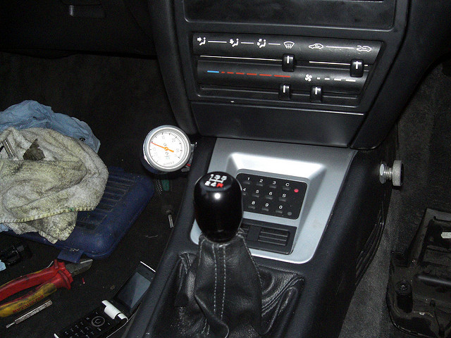

I wouldnt worry about oil pressure really, a boost guage is only needed for the initial setup too unless you have an in car boost controller but even then once its set thats it, i have a throttle to regulate boost :roll:
If it were me i would have an EGT guage, boost guage, and oil temperature, the later is standard fitment anyway.
CIMG3174 by Deanxm, on Flickr
