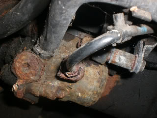

Those pipe nuts aren't going to move are they? I have found a bit of difficulty getting a 12mm hexagon flare nut spanner from usual factors/motorparts shops and even internet searches. Anything other than a hex is going to turn the corners off those unions in seconds flat.
Anyone discovered a source for such a tool?

Invariably you need to buy a set Neil. I have a set like this. Worth their weight in gold as off-times they can be used as ring spanners on ordinary nuts in inaccessible paces...NewcastleFalcon wrote: Anyone discovered a source for such a tool?

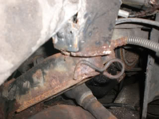

Any thoughts on dropping the subframes.
I think I read in a post on the forum once that the rear subframe is held on by 4 bolts, no doubt rusted to shearing point on the car. Do these poke up into the floorpan where I could cut them off from inside the vehicle?
Is the front subframe held in place by six bolts, two on the branches each side which attach to the inner wing and two at each side at the rear of the subframe?
Edit
Just spotted your reply on the subframes Paul-thanks. Does the anti roll bar come down with the subframes front and back? Does the bolt at each side of the inner wing "branch" need removing? Are there 2 subframe mounting bolts side by side at each side, at rear of front subframe?
Thanks Neil

Yes anti roll bars DO come down with the subframes
Yes the bolts are grouped together under the drivers feet area, and passenger feet area...(Fronts)
The rear drivers side, the edge above the fuel filler pipe WILL come past the filler pipe... so dont worry about moveing the filler pipe away..
Not sure what you mean : Does the bolt at each side of the inner wing "branch" need removing?
Theres no subframe bolts by the inner wings to remove the subframe..
