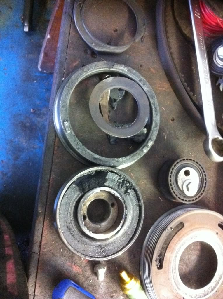

Unread post by Sid_the_Squid »
Well she's all fixed up now, and running nicer than ever!
The damaged was quite bad, looks like I was lucky the belt only jumpted a tooth or two, was very close to destroying the whole thing!
Heres a picture of the damaged parts.
