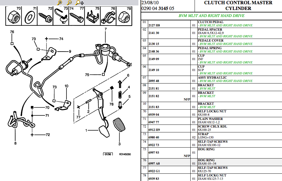

Does this slave look OK? Or is there a piece missing on the pushrod?

Isn't it bit like buying a chair with only 2 legs when it needs at least 4!?
The feed is a closed circuit to the master cylinder and this has had the snip!
I've seen guys bleed the circuit with care and a syringe but is this £20
money well spent?

It looks complete but it'll be fun joining up the pipe. It's very g=hard plastic and needs heating to fit over the spigot.
If you do buy it, fit a bleed nipple to the elbow as shown in this picture:
Bleeding is then a doddle

Thanks andmcit appreciate the exploded diagram!
