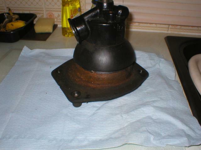

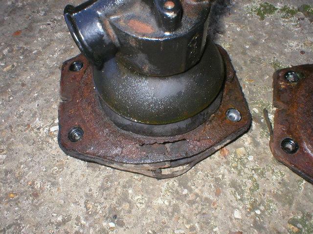

If the basepate looks like this:
then you have worries.
The basepate is bell-shaped and it's very important to check the integrity of the metal just below the dome. This are is normally rubber covered and if the rubber is all perished and cracked then there may be corrosion lurking underneath.
This example has rust under the (now peeled away) rubber below the dome:
But it is sound and not holed. It just needs some rust treatment on it and some protection...

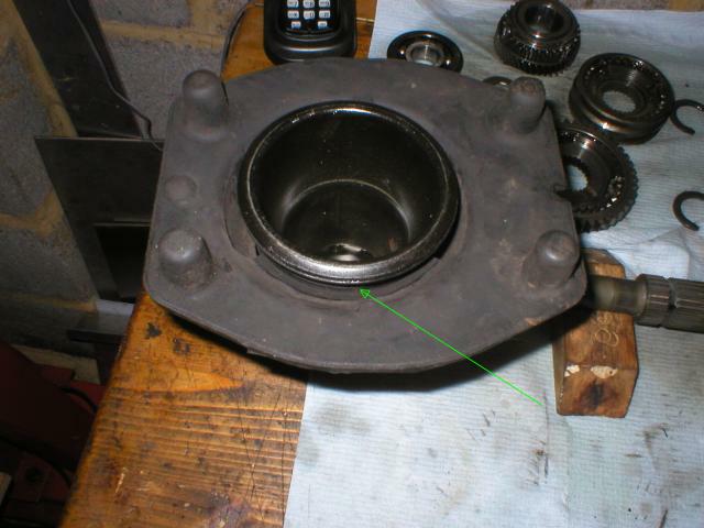

citronut wrote:i personaly belive if the rubber is de/laminatting in a big way that to is cause for concern,
I agree Malcolm so do check the rubber by the green arrow in this picture for cracking and general damage:
A bit of delamination around the edges of the baseplate, so long as the baseplate is sound, is immaterial provided the delamination hasn't extended right across the baseplate and propagated up into the bell-shaped area.

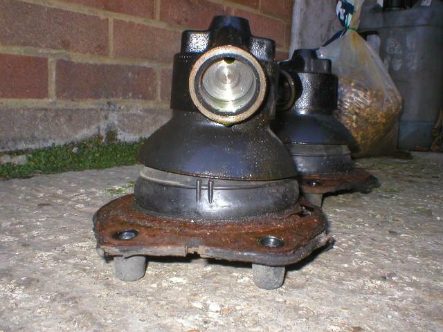

Also, off the car, look at the top side on from all angles. If it looks like this on at the front:
It is in imminent danger of going pop. The dome can be seen to be sitting at an angle to the basepate. It should be square on to it...
This particular one started to get very worrying as I unscrewed the sphere from it.
