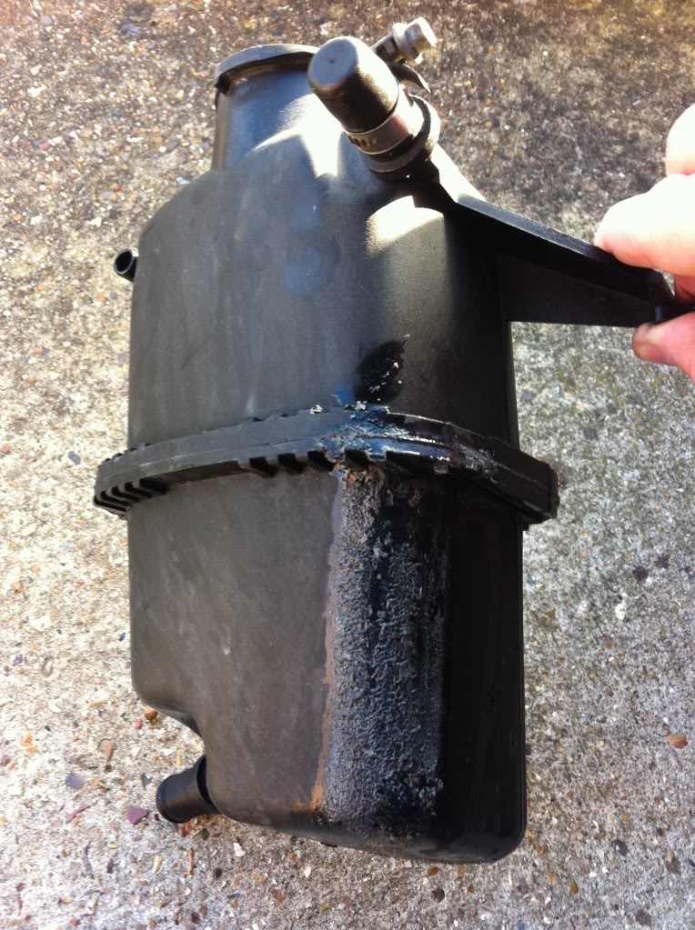

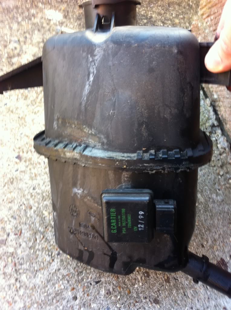

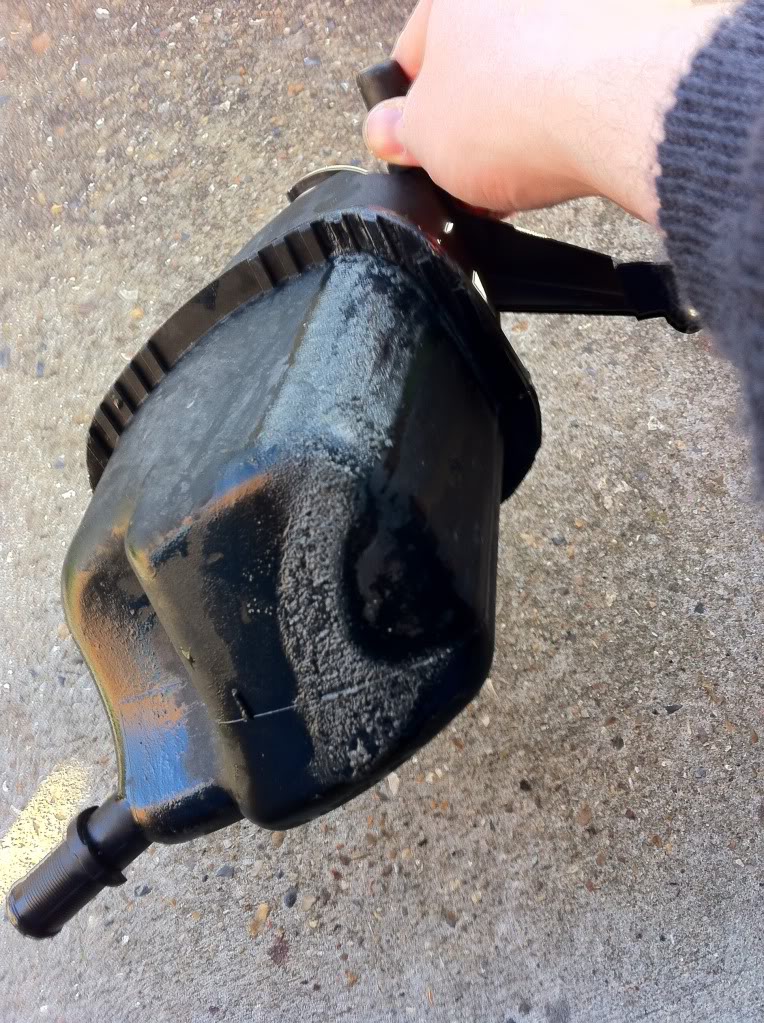

Hi all,
finally got time to change the green goblin's cooling system expansion bottle, I knew it needed chaining since I bought the car, (just another little thing your mechanic failed to mention Brett :roll:) what I had not realized is just how bad it was.
Heres a the damage :shock:
This last picture appears to have lime-scale formed on the side :evil: which is strange as I never use anything other than anti-freeze and deionized water, which suggests that someone has, and I need a coolant change asap :(

Gosh, that looks terrible Sid but may not be limescale. Anti-freeze crystallises just like that and that's most likely what it is. You can often see a real heavy buildup of these crystals on a weepy waterpump.
You can easily tell the difference. Limescale will be hard to remove whereas anti-freeze crystals will be very easy to shift.
A flush is not a bad idea for peace of mind. There are block drains on each bank to help you. On the MK1 they're proper drain cocks that you can attach a hose to but I see on the MK2 they are just studs so it'll be a wet and messy job to use them...
