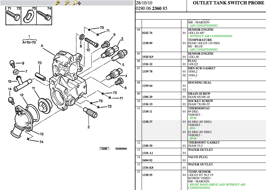

I have pic of from a MK2 Xantia.
andmcit, are they similar?
Edit: Now, I know that they look similar, different design :)

I'm going by a mk1 even on a 97 although this is the crossover isn't it!? :?
Another query would be the differences between the 8v and the 16v.
I'm going by the set up which is the same as the 2.0i I know well!
Andrew

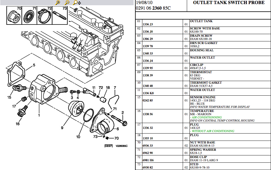

Unread post by andmcit »
No difference in design between mk1 and mk2 8v and this is Mk2 16:
Andrew

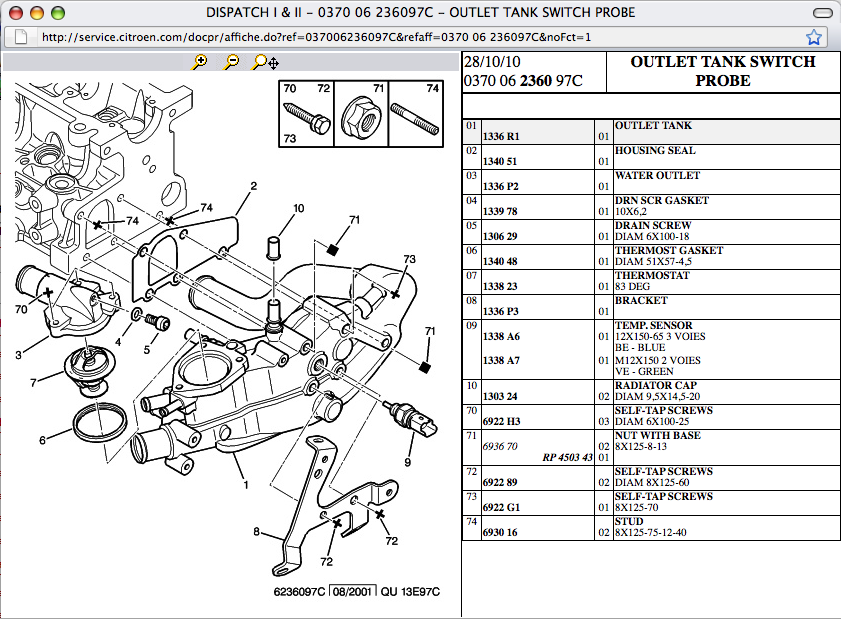

joyfulnosaj
Posts: 22
Joined: 24 Nov 2010, 22:58
Unread post by joyfulnosaj »
andmcit
any chance you have diagram for the thermostat asssembly for Disptach 2.0 HDI 2002 or therabouts
andmcit
Posts: 4299
Joined: 03 Mar 2005, 17:59
x 30
DISPATCH I & II PANELLED VAN - LONG TYPE 900 2.0 HDi (DW10BTED+)
Any use to you? :D
Andrew

Nekkid wrote:Actually, it's 2 bolts and one nut, which I didn't see till I'd prised the housing loose and snapped off the bottom corner of the flange (where the nut sits). Whoops!! I put a larger washer under the nut so it holds the flange in place and it does't seem to leak!
Hi Charley,
whoops indeed. Apologies if I misled you with the number of bolts fastening it!
I've only seen these with x2 bolts and do believe the housing is one too few
to triangulate the fastening and it's foces which appears to have been rectified
on the later cars. Least it appears to be holding but it needs to be watched
as the sudden failure may lose coolant with bad consequences to the engine.
These thermostat housings aren't hideously expensive - the one pictured is
showing up as:
00001336J4 WATER OUTLET 10.69 GBP 12.56 GBP 12.56 GBP
modest money for what it does!!
Andrew
