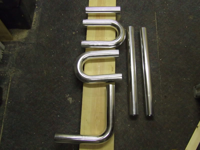

Managed to pick up these polished pipes for £20.
I will be using these to replace the top inlet pipe (plastic one), this will rid me of the boost vent pipe that goes to the controller, not a problem as it will have an MBC and doesnt need it, also the breather hose will be to ATMO and re-routed to a catch tank with filter. Finally the redundant dump valve return wont be used either.
The pipe I/D is within 1mm of the original, being metal it should not suffer from as much heatsoak.
I also have the pipercross filter, need to order an adaptor for that, will take a picture shortly. I'll knock up a heat shield for it so it doesnt suffer too much from heatsoak.

Nice find, could i be cheeky and ask where they came from or is it a bargain clear out from somwhere. When ive sorted the interior of mine i want to re plumb the intercooler and get a good cold air feed run into the engine bay, trouble is there isnt a great many options, i dont want a bonnet scoop, there is no room at the front by the grill so i may have to put a scoop in the bumper by the foglights and run it over the gearbox to my cone.

They were left overs from someone on Rovertech. Its for intercooler piping, 57mm OD. Normally go for a lot more on ebay.
