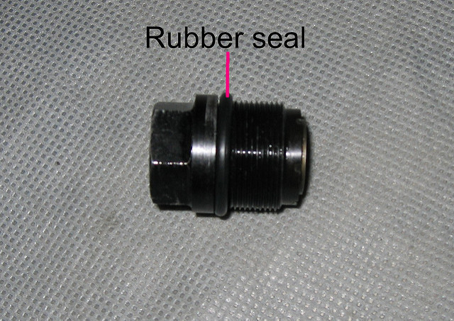

The leak is usually from the rubber seal around the outlet pipe union, here's a photo below.i3 wrote:I dont have a clue where the large one would fit onto. anybody have any pics or diagrams of where the o-rings are on the hydraulic pump, so i could establish where the leak is from. thanks all

The most likely place for leakage is from the delivery valve O ring as shown by the red circle and item 5 in the picture below..
It is easy enough to swap, albeit messy. Release the P clips on the pipe, undo the 12mm upipe union using a flare nut spanner (very important) and carefully withdraw the pipe, taking care not to bend it.
Then undo the 19mm hexagon and carefully lift the unit out, minding that under it is a strong spring and at the very bottom a ball and ball cup. It you lift the valve very carefully, the spring and ball/ballcup will not be disturbed.
Plenty of LHM will leak though... I find a baby nappy laid on top of the alternator is a good way to catch spilt LHM. If anyone was ever wondering, that's why there's a bag of nappies in my workshop!
Renew the O ring (which will be at the top of the threads on the valve body and reassemble.
Don't overtighten anything, especially the 12mm pipe union, it only needs to be nipped up.
Try to clean up the alternator as much as you can. LHM can hurt an alternator. If it is really full, take it off and wash it out using an airline and a gentle electronics solvent...
The picture will show where the big o ring goes...
Hope that sorts it, it's a very common leak...

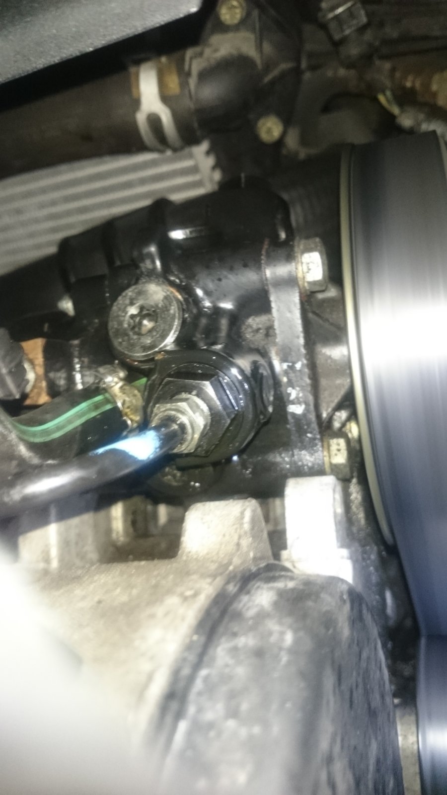

Re: lhm leak
Hi Guys.
I know that this topic is more than 9 years old, but i think that this could is my case and decide to join this discussion.
I've noticed that LHM weeping from one pipe connectors on pump itself. Just want to make sure that I'm thinking about same seal for my issue I decide to ask before I go any further.
Here's my problem - pipe with blue mark on it
As you can see, some lhm running down on pump right towards alternator :/

Re: lhm leak
It is very likely to be the 19mm o-ring that is leaking, I have needed to replace them on most of the Xantias and XMs that I have owned.
You could buy an identical replacement o-ring from Citroen, but I would recommend buying o-rings made in Viton, which is more heat resistant and has a longer life than the original o-rings, which I think are made from nitrile rubber.
In this application I also recommend slightly increasing the cross-section size (from 2.4 to 2.5mm) as I think that Citroen were a bit mean with their sizing, and the 2.4mm o-ring is a bit of a sloppy fit in the groove.
Here is one supplier of 2..4 x 19mm Viton o-rings: https://www.ebay.co.uk/itm/Metric-Viton ... rk:20:pf:0 I am just giving this link to illustrate that they are readily available, I have not used that particular supplier.

Re: lhm leak
xantia_v6 wrote: 10 Dec 2018, 17:33 It is very likely to be the 19mm o-ring that is leaking, I have needed to replace them on most of the Xantias and XMs that I have owned.
Many thanks for quick reply. I followed advise and ordered 2.5mm, as mentioned above.
I'm guessing that whole operation need to be done after complete system depressurising (car suspension on low setting and release pressure - bolt beside acc sphere in front) ?
