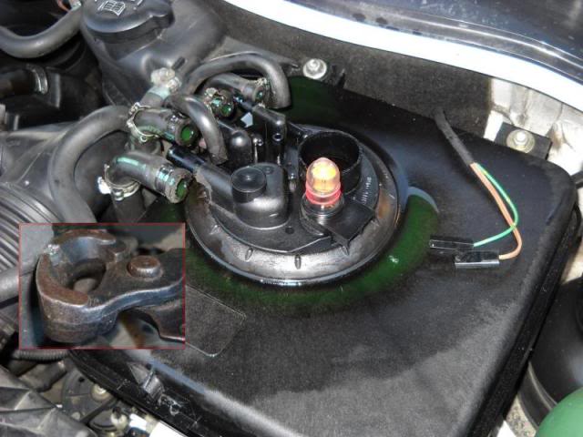

Check the LHM with the suspension on high and give it time to settle.
Fill so that the indicator is between the red markers. Don't overfill it, enough is enough :)
Try and get the LHM out of the coolant reservoir - either soak it up with rags acting as wicks, disconnect it fron the radiator and drain then flush it or the really lazy way, overfill it so it overflows and takes the LHM with it - onto your drive :)
When you next use the car it will chuck the excess out anyway.

Then you have a nice weekend job :wink:
There are good instructions in FCF. I have printed out CitroJim's "How_To_Guide" and have it in owner's manual 8-)
You nead 5 lt LHM and some cleaner in order to clean filters inside the tank and the tank.
:idea: : I use an old tooth brush for filters
Lots of rugs and patience ...
