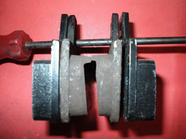

I thought I'd change my brake pads and started at the rear only to find they've worn unevenly and actually have a pronounced lip on the top.
If you compare the new pads, the old ones appear to be too long, hence the lip that hasn't been worn.

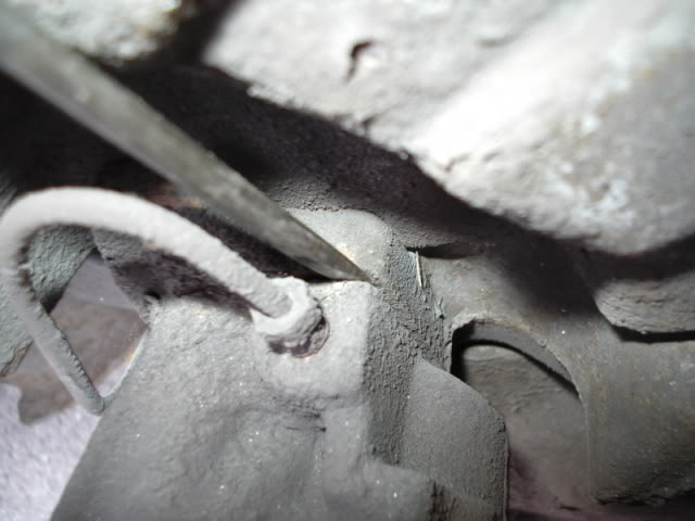

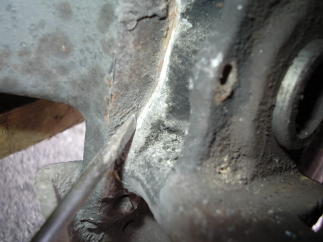

As for the angled wear, I would naturally assume it's down to the infamous caliper corrosion but before I embark on fixing that, can anyone confirm that is indeed the problem and the surfaces I need to derust are as indicated by the tip of my screwdriver?

The angled wear is indeed down to the corrosion pushing the caliper out at an angle.
Remove calipers, some people have had the bolts snap, I haven't on either Dex or Cassy, but I don't think replacement ones are that expensive so if you'd have no way of getting to a dealer if they do snap then buy a set before you start.
I used a cold chisel and a wire brush to clean up the backs of my calipers, then some grease between them and the arm to reduce the rebuild up of corrosion.

From the photo, it looks to me as though the old pads are for larger diameter discs, but the new ones seem to be nearer the right size.
A hatchback Xantia should have 224 x 9 discs. Could it be that it has these discs but calipers for the larger size?

I've got the bolts out ok - using a half turn out, quarter turn in method but the brake feed pipe doesn't want to come out :?
I'm with you Old-Guy, the old pads are too large for the discs. I'll measure the discs to make sure they're the right size. The inner disc surface has a bad groove worn into it too so might need to change them at some point - not this year though.

I also had this unusually carved rear brake pads! Never before and never after, I'm sure it was a production mistake.
I used the same pads one more season, by filing away the top "lips" :)

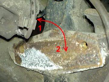

White corrosion is a known issue and it needs to be cleaned.
As Xac said, after cleaning, apply some grease (copper or aluminum paste is also fine) on both surfaces (1 and 2).

MikeT wrote:I've got the bolts out ok - using a half turn out, quarter turn in method but the brake feed pipe doesn't want to come out :?
Have you soaked them in Plus-Gas Mike?

I got the brake pipe out with brute force after learning there's piece of rubber hose inside used as a seal. I was just being too delicate with it. Toby kindly fetched me new seals from the stealer bringing back four for a fiver.

I also want to question the wisdom of using copperslip where corrosion occurs between two dissimilar metals? Would a tri-metal meet be even worse?

I have to agree with you, Mike. Being higher up the galvanic scale copper should make matters worse by increasing the galvanic voltage.
I know it's common practice to use copper-slip between rear caliper and suspension arm. The thinking is that it's designed to resist high temperatures - the flaw in this is that the copper is designed to remain as a low-movement, high-load, lubricant when brakes get so hot that the grease boils off.
In practice, it probably works OK in temperate climates because Xantia rear brakes rarely work hard enough (except when towing?) for the calipers to get at all hot. Any HMP grease would do to make the surfaces water-proof - probably just any grease.
When I come to do mine - still on the same pads after 3½ years and 33,000 miles (quite possibly the factory originals!) - I intend to paint the swinging arm surface with at least 2 coats of black heat-proof (wood-burner) paint.
The real cure would be to have the calipers anodised - but that's a bit OTT.
