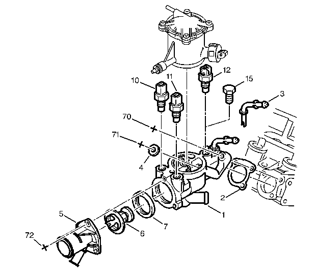

Which one do you need the one that sits between the back of the housing and the head ?
1339 62 is the number for part (2) on this diagram:
The dealer should have cheaply. Try a Peugeot dealer if needed, as far as I am (aware) they are all the same for the housings with the filter mounted atop. Certainly the water opening aperture is the same for all XUD's , you might have to say its for a 306 or something if they get funny.
Note this pic is from a late (but XUD) 306:

Thanks Andy its definitely item no 2 on the diagram. I probably should have sourced a new no4 as well.
