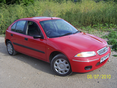

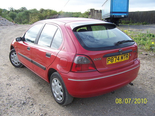

Its got 91k on the clock which is climbing fast, there are scratches and a 10p size dint in the rear door which i was going to repair and respray but im sure it will sell with this and since im busy and using it daily i just havnt had the motivation, in the last month its had......new mot, 6months tax, cam belt, tenioner, water pump, aux belt, air/ oil filters, plugs, and distributer, stat and some other bits and pieces to that ive forgoten and it now drives like a new car, very tight no rattles or bad habbits.
Edit! im looking for about £695, not sure if this is expensive for one of these on the mainland but over here they go for about £900 so since the door is sratched i thought this about right.
