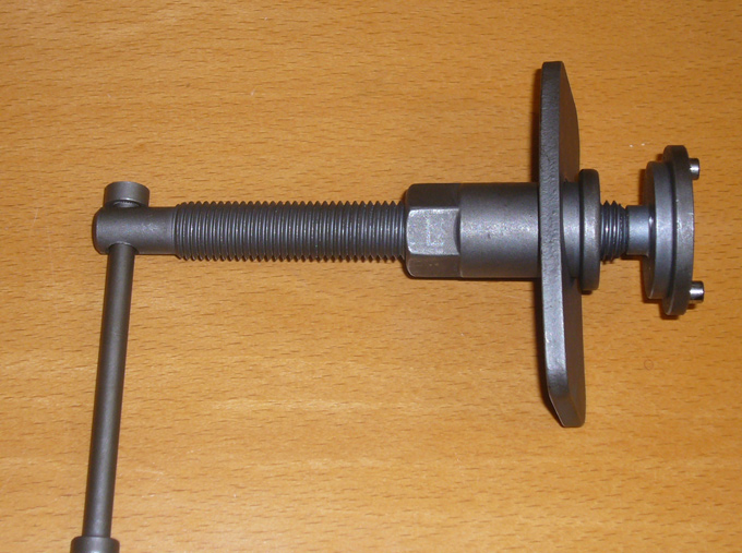

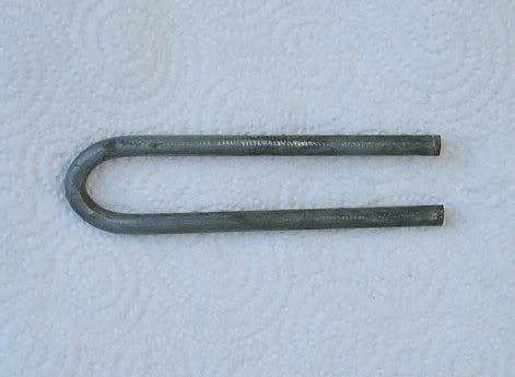

I made this tool which winds the pistons back easily.
The prongs fit the two grooves in the piston.
Pressure on the rounded end pushes the pistons back whilst a T-bar through the prongs winds them.
Note: They go in much easier if the bleed valve is opened.

JohnD wrote: Note: They go in much easier if the bleed valve is opened.
As it is, it is advisable to open the bleed nipple anyway, to prevent dirty fluid being forced back into the ABS system, which can be damaged by this action.
