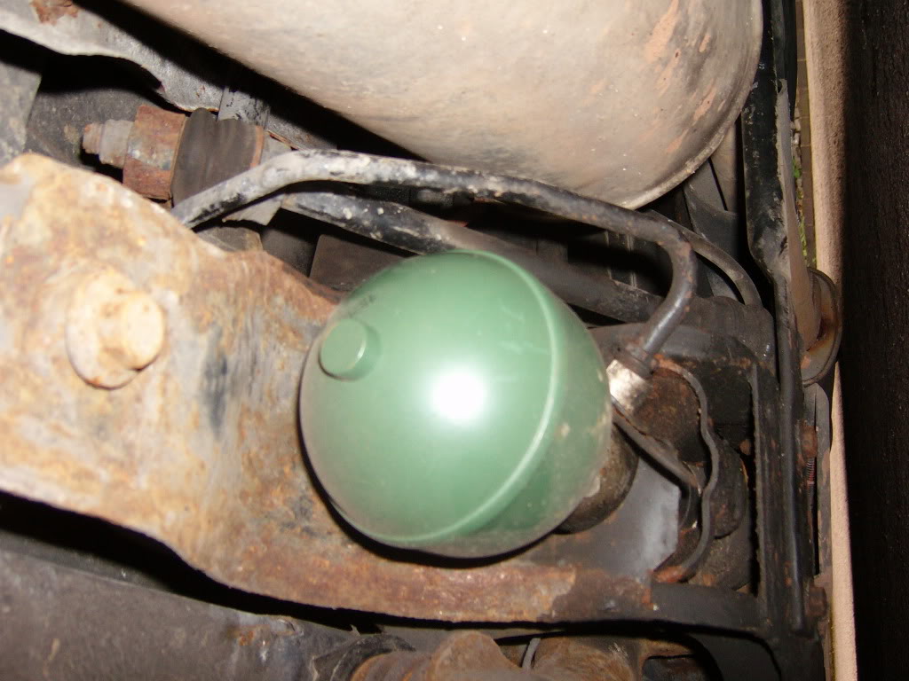

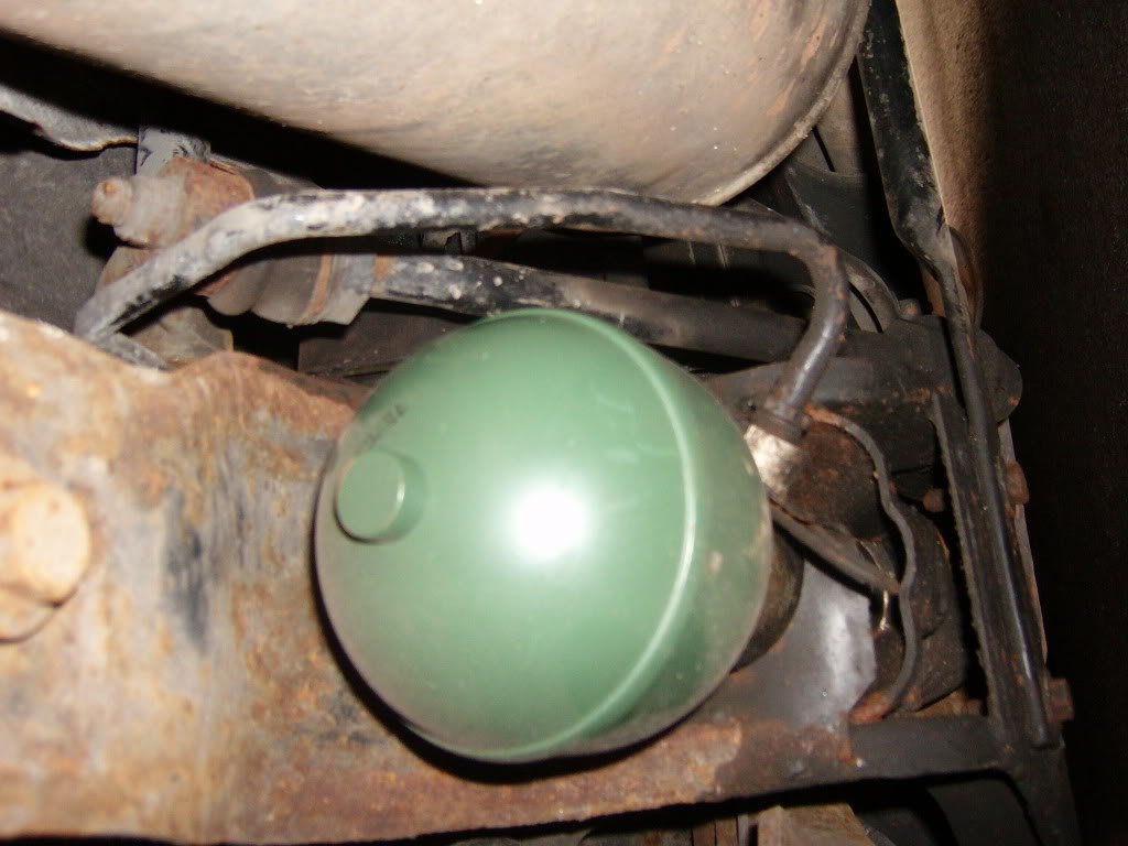

You can't see the movement in the videos I've made as the camera's so rubbish, but in these pictures you can clearly see movement in the top ball joint. So that rules that out as a possible cause for the height differences?
KevMayer
Posts: 1051
Joined: 12 Sep 2003, 22:01
x 2
Unread post by KevMayer »
The movement looks like what you'd expect to see.
