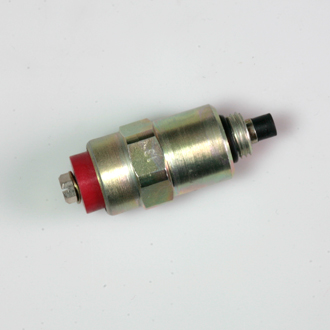

I don't have one to hand to take a picture, but basically its the unit itself and a spring and plunger and an o-ring.
It looks a bit like this (I just found this pic via Google, its not exactly right for yours) but the design and picture is:
You can see on the black end the plunger (the black part itself, made of rubber) the spring is inside that. Then on the thread the o-ring (a new one will come with this, and the old one will come out usually with this attached)
Still strange as if you do have a Lucas pump, its a Lucas part anyway...

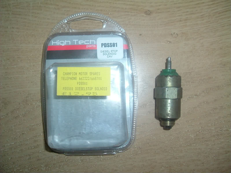

myglaren wrote:Whereabouts are you
I was thinking the same thing myself.No motor factors etc.You live on an island or something? :P
And..what make/model/year of car is it?
The stop solenoid in your picture looks just like mine that failed.
Old N reg,i think, pug 306 1.9D,none turbo.
Here it is, in it's replacements packaging, (why the heck i kept it i've no idea!) PDSS01:
Have you tried 'the bay'? According to my replacement here's one,albeit dearer than a motor factors/car spares shop:
PDSS01:
Diesel Stop Solenoid - CAV
Some go for under a fiver:
Puegeot Stop Solenoid
Do a quick search,just make sure you get the correct one. Simple job to fit,unless your local garage aint greedy :wink:
PDSS01:
I live in Saffron Walden, it's a small town in Essex. I'm hoping with the help of some of the guys above I should be able to find a place that sells them, or possibly one on eBay.
The packaging is a great help, and it looks like the exact part. Now I have the part number that should really help, thanks ever so much!
