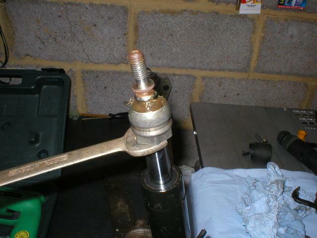

You'll need a thin 19mm spanner and a 32mm spanner to remove the old balljoint...
Here's a few pictures:
Balljoint nicely re-greased and thin 19mm spanner in position:

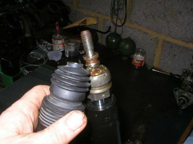

The gaiter, showing the groove around the balljoint that locates the top of the gaiter and makes it's removal quite tricky:
The gaiter is a very tight fit around the body of the balljoint and it takes quite a careful tug to pull it free.
