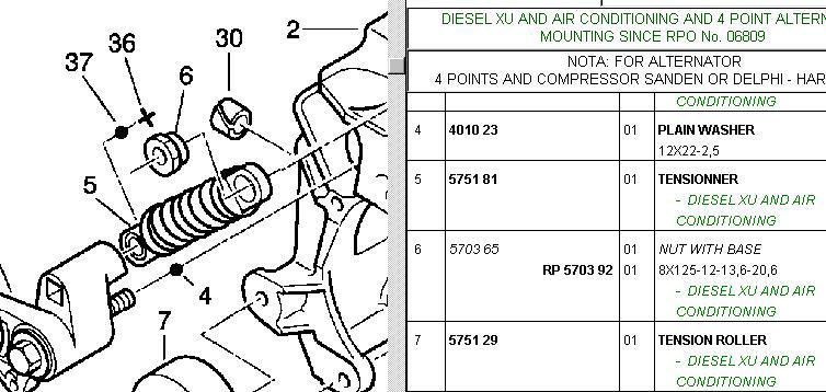

Hi,
I have finally got someone to do the auxiliary belt and tensioner for me.
Unfortunately it was not the tension roller that was at fault, but the spring itself. The metal forming the ring at one end of spring had fractured, allowing it to rattle, and eat into the holding bolt.
I tried to get the part number from the citro site, but couldn't get to the page I required. Searches called auxiliary tension spring came out at a big zilch. Cambelts, and aux belts also came up with a zero.
Can anyone tell me the path to get to the drawing with all the tensioner gubbins, or the part number for the spring??. The price may be handy too---to see how many drinking vouchers I need to forfeit to buy the infernal bit.
Thanks,
Greg

Hi Greg,
I can but I beleieve GSF sell this item under this part number. The description is very poor..
135PC0100 RIBBED BELT TENSIONER XAN 1.9TD + AIR 96> SELL WITH N13179 43.70
The Citroen part number is 5751 81 and shown here in the picture:
