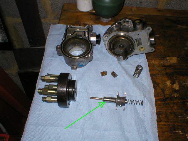

Jonesy, where are you? I'm sure if there is a Lexiated member near you they'll be happy to run a set of diagnostics.
I can help with an EPIC strip. I have a duff pump here I've stripped once but neglected to take many photos.
They are actually very easy to strip apart; easier in fact than the Bosch or Lucas DPC.
Here are a couple of shots:
ESOS valves:
Distributor head:
I have nothing "official" on them but they're actually so simple, there is no need.
Any help I can offer...
